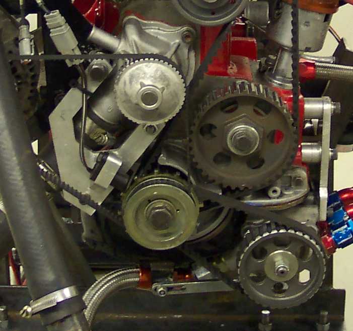

Next, buy a 12 tooth chopper disc from motec, and mount it to the front of your engine, like this.
Use a GT101 to read the sensor mounted as you see in the picture.
This will give you a good reliable ref and sync setup for your car so that you can run sequential injection and even 4 individual coils as well.
