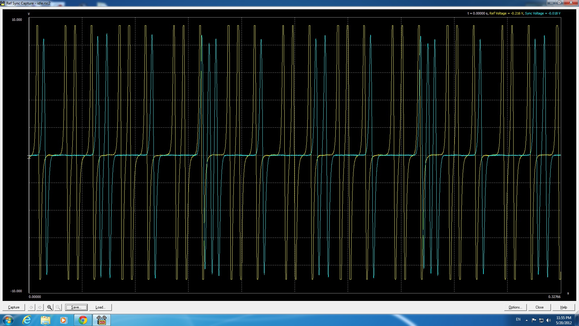

I am having trouble with constant ref runt, sync runt and sync lo level errors, i have looked through the webinar and i have some understanding on what those warnings are and how to treat them and i will play with my filters after i have exluded all other error scenarios. But after looking at my ref/sync capture i am buffled, but then again, i am a noob and the only thing i have are fragments of webinar memories and no experience whatsoever, so please, help me understand this capture.
The car is a 1995 subaru impreza wrx sti with ej20 engine, no AVCS.
The only thing i understand from looking at those waves is that my both my ref and sync are magnetic type and both have a falling wave, but i have no idea if CRIP and CRT are set correctly for this engine, can someone shed some light ? I'd really appreciate it. Thanks!
Here is the ref/sync capture and my sync/ref setup. It wave captured at idle, which is around 900 rpm.

Those are standard settings for your engine. They should be correct.
CRip refers to the TDC reference, again Motec's base settings will be correct. Although the instructions will tell you how to check this with a timing light on cylinder 1.
As for the ref/sync/runt errors etc.
I get them all the time too on a friends Subaru. Despite them, there seems to be no noticeable effect on how the car runs and it's been like that for years.
I did try messing with some of the filters, but it didnt really seem to make much difference. They only occurred at higher rpm's though
Just gave up worrying about it in the end.
Just to add. you would need to do a ref/sync capture at high rpm to try and see if any filter levels are being exceeded by noise. Chances of it happening at idle are slim.
As you can see on your traces, the signals are good and clean with virtually no noise showing.

So the reference and sync looks alright to you at idle ?

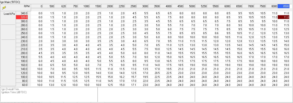

The other issue i have is pretty high EGT's on a very conservative tune with low lambda numbers, the car is running 10.5 afr and yet it's still heating my EGT sensor to 900C on mildly spirited runs. To me, it's an indication of either too much of a retard or advance, but that is not the case with my map, i will also attach my ignition table.
Also, if these graphs do not give any indication to an incorrectly setup ref/sync, could anyone recommend me ref/sync mag and filter tables. The voltage also looks a bit excessive to me, but what do i know.

Sync trace below
Ref trace below

It would be more likely to have hot exhaust from retarded ignition.
What are your ignitions relative to?
(i.e. where you want them, or is the spark actually happening at those values?)
You will need to set an offset from the CRIP to the TDC or something along those lines. I would break out the timing light.

A thought has crossed my mind, what if the person who first mapped my car, did not bother to check that his CRIP value was correct in relation to TDC and simply started mapping from whatever default value he found for my car.
So now, if for whatever reason my TDC shifted (sensor moved, any other reasons ?) in reference to his CRIP value and even if i set my CRIP correctly with a timing light, it might still end up not being the right CRIP setting that makes my car run fine on this map ?
Is it a viable scenario?
Sorry, just trying to get my head around all this information.

Postby Blu302 on Mon May 21, 2012 7:42 pm
To correct for a variance in the Crip value, you can change the whole map by using overall trim under the Adjust>ignition tab.
