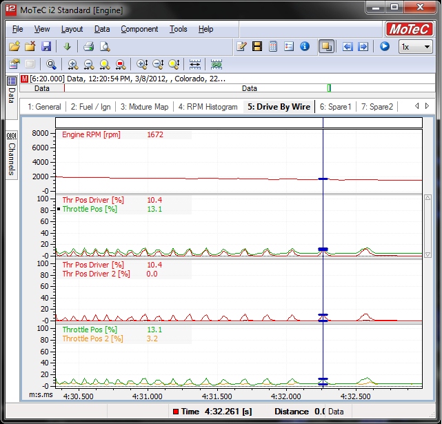

I was curious if anyone else using DBW gets noise in the signal from the pedal (M800 using the dbw feature on the ecu)? I rewired my project car's throttle due to small blips that were showing up in one of the (Driver Request... pedal) inputs. I reran the wires to the pedal as well as the wires to the throttle body, using new shielded tefzel, brand new connectors on each end, brand new pedal and throttle body, verified the pinouts about 50 times. While the engine is off it works perfectly (has always been that way), but as soon as the engine is running I can see a blip of about 10% about 2-3 times a second. As you can imagine that really screws with the idle, and you can feel it while driving, and you can see it in the logs. TPD will blip, but TPD2 will stay where it should be (0% during idle), TP will blip to 10%, TP2 will follow TPD2 perfectly or the idle request perfectly.

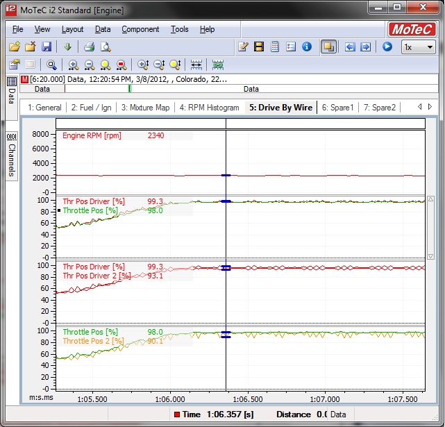

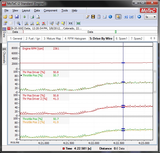

Postby BluByU on Fri Mar 09, 2012 2:17 pm
Had a chance to log 3 different situations (Full, partial, and idle)
At idle, TPD and TP both blip about 10% while TPD2 and TP2 stay where they should be
While accelerating, it looks like some type of differential signal is happening
While at full throttle it looks like the reverse of at idle where TPD2 and TP2 are maxed and TPD and TP dip down.
So the partial/accel log appears to point out the problem in all situations, if you average the two signals it is fairly flat. Now I just need to figure out what would cause that situation.

Postby Holmz on Fri Mar 09, 2012 6:14 pm
In the middle screen shot the "train of pulses" are ~0.8 seconds apart (or 1.25 Hz).
The individual pulses are ~0.1 seconds apart (10-Hz).
If you did an FFT of the throttle position you will see the exact frequencies and can see if they are the same for WOT, cruise and idle.
Then you have see what happens at 0.8 and 0.1 seconds (1.25 Hz and 10 Hz). I think that could help.
I would also 'up the logging rate' on that as there could be more happening at higher frequencies.
