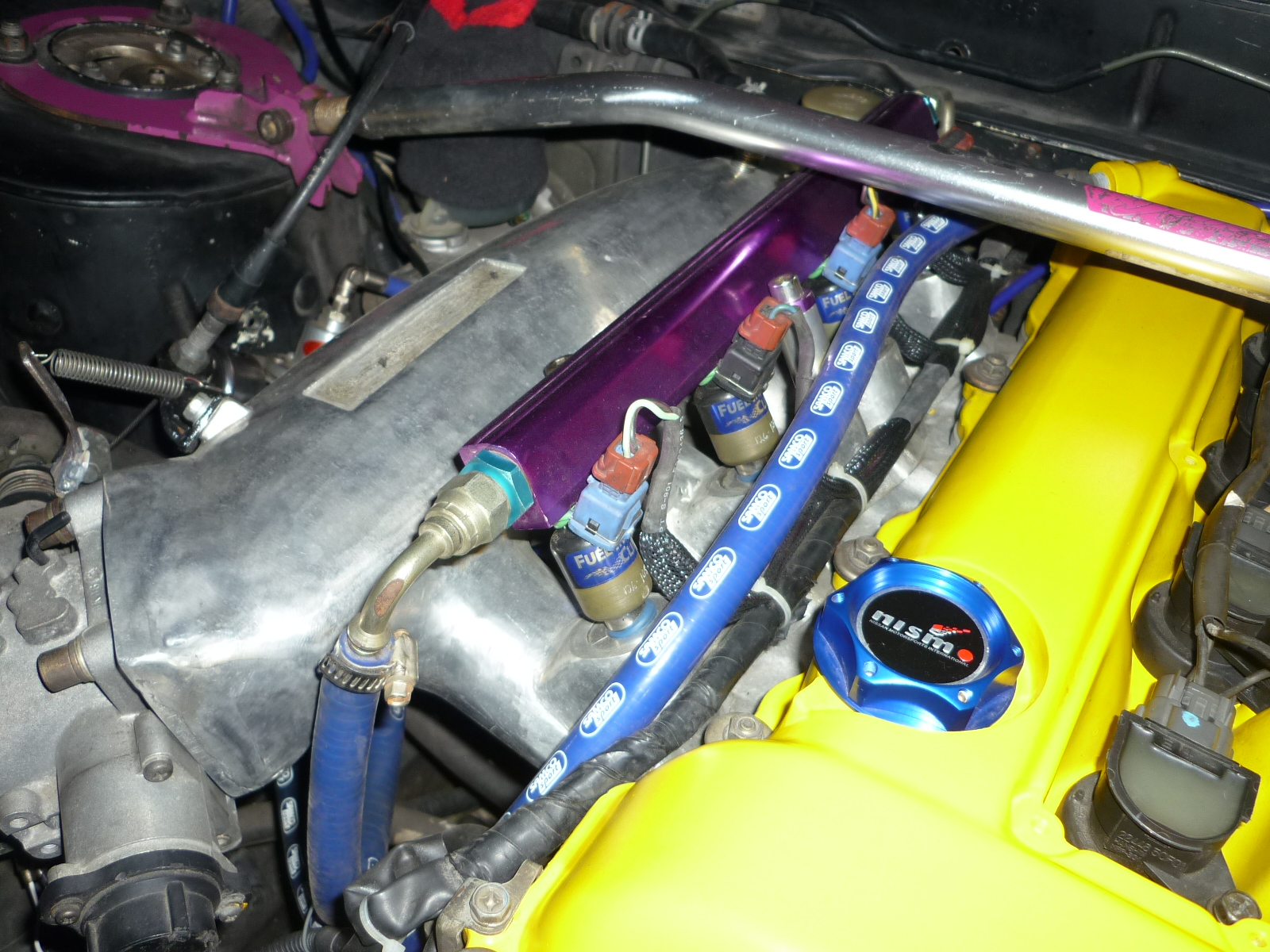

Hi
this is my 1st Motec ecu M4 pro
my engine setup as below
SR20det
GT3076R turbine
FIC 1050cc low ohm injector
Greddy intake manifold with 70mm throttle body
big FMIC kits
std cam shaft
walbro pump with 20psi w/vacuum
the problem is the air fuel ratio too rich (11af ) at idling after I change my 510cc injector to this FIC 1050cc injector .
I know we can reduce it at fuel map right , but even I reduce the loading point ( idling ) to 0 it still too rich .
but once the vacuum loading point near to 0 vacuum everything go find .
the problem stared when the loading point go below -0 vacuum .
can anyone here help me out of this problem .
Thanks a lots

Postby stevieturbo on Tue Feb 21, 2012 3:43 am
70mm TB will support double that power.
And the injectors will never work properly at such low pressure which could be contributing to the problem. They will just dribble fuel out, not spray it as a fine mist as is required.
What are your actual injector pulse widths at idle ? Are they wired correctly in firing sequence ?
And fitting bigger cams will only make the situation worse, so you really need this sorted first.
In the picture, the first injector looks like the seal is not fitted correctly, are they all like that ?
Restore fuel pressure to a sensible level, then try and tune for an idle at say 2000rpm and see if that works. If it does and you have control, perhaps adjust injection timing to see if it helps and then reduce the rpm's slowly
Although if you have a zero in the main map and the engine still runs, something else is badly wrong. The engine should stop, as no fuel should be injected. So confirm there are n strange settings within the ecu and confirm at zero fuel pulse widths are zero.

Postby wenya on Wed Feb 22, 2012 2:45 am
stevieturbo wrote:70mm TB will support double that power.
wiring all correct
will fix the fuel pressure and try it out .
the injection timing is RPM 1000 ~250 , RPM 1500~275 at the moment .
the pulse widths is 0.2 at idle .
I'm not going to install the cam yet , now trying to get the idle done 1st .
wenya
