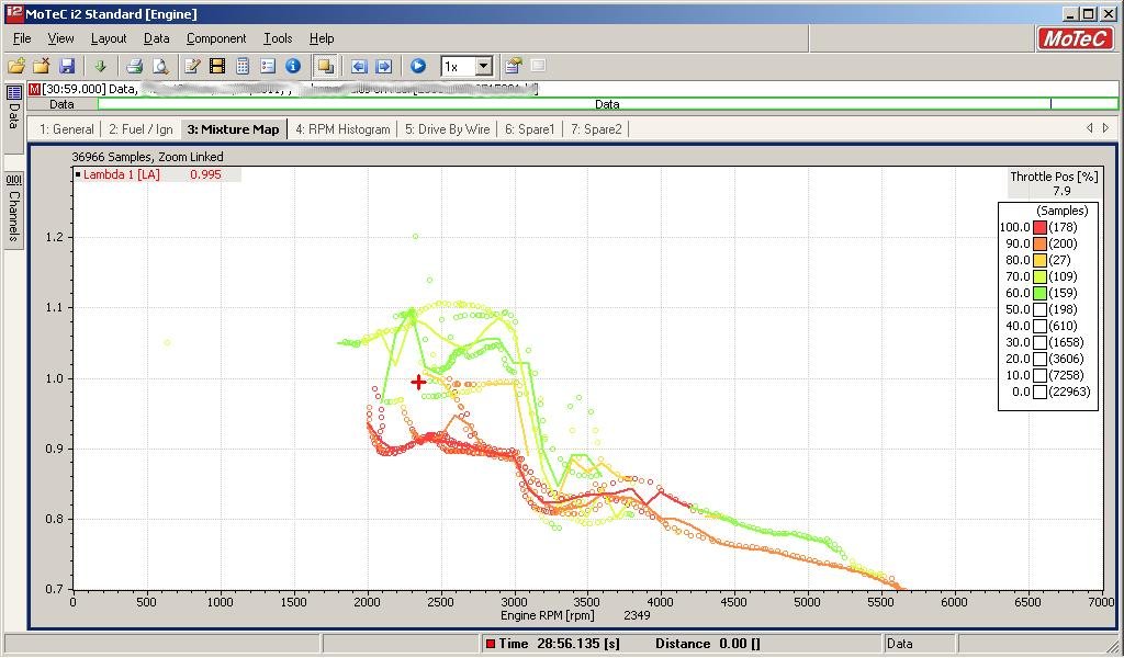

Progress!!
Last weekend fitted up the wideband and wired in a map sensor...
as you can see below... Toyota tipping it all in above 3000rpm since 1978...
swaped engine temp to an AV in and it seems ok, may still fit a stand alone delco sensors for ET and AIT...
managed to get it to idle with the motec controlling fuel so very happy with that!
