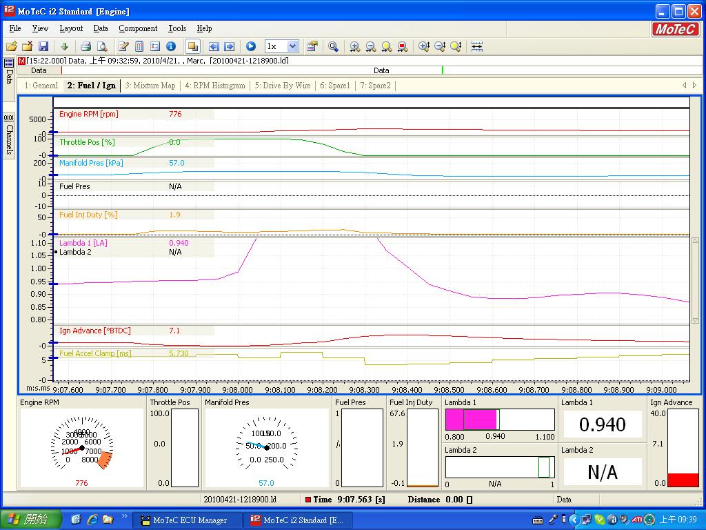

Postby Marc on Sun Apr 18, 2010 1:35 pm
RossB wrote:Alejandro makes a very valid point regarding injector location. If you have an injector located a long way from the valve you may have difficulties getting good throttle response when using a lean steady state mixture. You could test this quite easily by making the base mixture richer with a trim and repeating the test.
Hi RossB,
I read this issue that is more like my M800.
The defferent is the injector far from the port after the throttle.
I have multi throttle syetem.
When 0~10%tps la=1, 10~100% slowly from la= 1 to .87 .
I have map the main fuel table by these LA .
No matter I set the accel parameter , it always lean spike and a little improvement.
As you say in quote, I need try to set LA richer in idle from tps 0% (I will try LA .87)
Or begin from tps 1% to set richer base fuel map.
Please provide some suggestion.
BTW, the help in MoTeC say sync position ideal value is 20~80%.
But my sync pos is 87%.
Does it work normal for accel reponse?
My injection timing is 270 ,1000 rpm.
Very appreciate.

Postby Marc on Wed Apr 21, 2010 2:46 pm
Hi Martin,thanks for the help :D
My Accel Threshold is 50 units/sec.
Setup value:
Accel calmp
1000
50
Accel decay
1000
15
Accel sensitivity
1000
100
I only try from idle.
Please give me some suggestion.
Thanks all.
Marc

Postby Martin on Wed Apr 21, 2010 4:20 pm
Make accel threshold lower for the accel to work for smaller TP ROC values. This will make it activate accel fuel earlier as it reacts at a smaller number, (quicker)
Re: immediate fuel accel
Postby RossB on Thu Apr 22, 2010 9:45 am
Martin has made a good suggestion regarding the accel threshold try droping it to about 25.
You need to log the channel "Accel Fuel" so that you can see in detail what the accel enrichent is doing. ALso you should log your Lambda channel at a higher frequency and reduce the filtering on the Lambda input. You can do this in the input setup by changing the filter value from "8" to "1". You only need to filter this channel if you are using closed loop lambda control.
