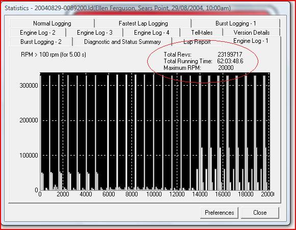

Is it possible to display the actual TIME and not just the percent in the RPM histogram?

Postby David Ferguson on Tue Mar 15, 2011 1:23 am
Like This?

Postby Spinner on Tue Mar 15, 2011 6:40 pm
That's great, but which program is that?
Yes, total running time is what I'm after, but also running time per RPM site on the RPM histogram.
I know its there graphically, but is it possible to get it displayed without having to export to Excel?

Postby Spinner on Tue Mar 15, 2011 8:20 pm
OK, I installed old interpreter, but when I open a logfile and press the Engine log tabs, nothing gets displayed. Am I missing something, or is it not able to display newer file versions?
