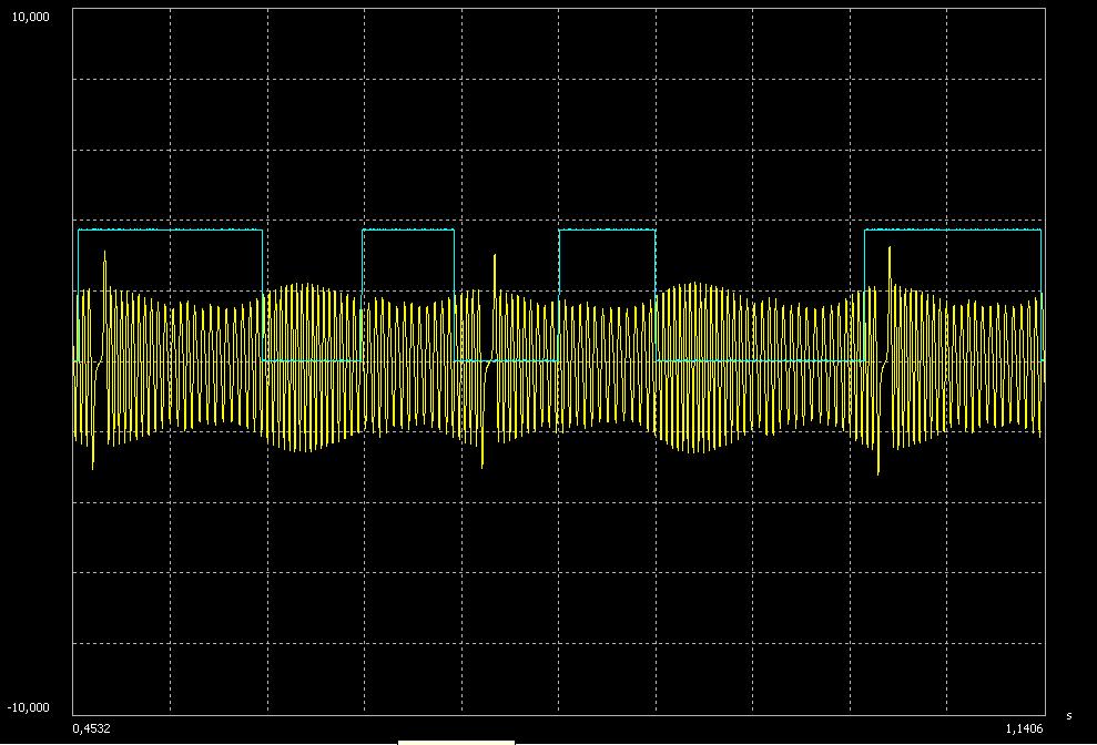

Hello, here i have some Peugeot 206 RC with 60-2 and sync signal like the image. What Mode its the correct? I try so much...

You use mode 28, it's the same as toyota's 4-1 on the sync. The toyota is 36-2 on the crank tho where this is 60-2.
Crank teeth = 60
Ref Sensor type = 2 mag
Ref Edge = 0 fall
ref trig volts = 0
Sync sensor type = 1 hall
Sync Edge = 0 fall
I don't have a CrIP value to give you.

Thanks!! works ok!! :D
