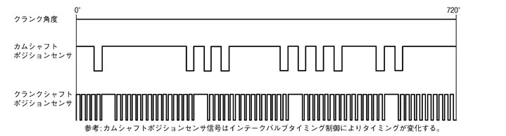

I've not captured the REF/SYNC signal though, I've found the signal figure in the service manual,
does this help you out to find out if you have any information, Darren?
The graph saying, crank angle, sync signal, ref signal from the top.
Both REF/SYNC is hall type sensor and sensor power/output signal is 0-5V.
(signal normally outputs 5V, become 0.5V when tooth comes close)
SYNC is also used for CAM position.
seems like REF teeth is 36, two missing teeth 4 times per cycle.
Firing order is 1-3-4-2, SYNC teeth seem representing cyl number
(cyl1=1 tooth (no additional), cyl2=2 teeth(one additional) ...)
How should I setup the REF/SYNC setup as well as CAM position setup?
Will REF/SYNC mode 9 work for this? or can I use OEM mode 42 perhaps?

Postby Shiggy on Sun Jun 28, 2009 2:14 am
Just find REF/SYNC diagram for CR**DE.
QR25 Hall sensor outputs seem opposite to CR,
then SYNC signal position to REF (and also REF/SYNC signal position to TDC's) is different.
Though REF/SYNC teeth seem identical.
I still can't capture the signal using M800 because the unit is still in use for other engine dyno.
Hope these diagram help.

Postby DarrenR on Mon Jun 29, 2009 10:30 am
Hi Shiggy,
Yes i can confirm this is ref/sync Mode 42, the same as a CR engine, so no problem there.
And we have not ran this DBW motor before, so it will need to be given to your local Motec dealer to be sent here to be charactrised.

Postby Shiggy on Mon Jun 29, 2009 11:21 am
Thanks Darren,
So what I need to do for REF/SYNC is,
Set REF/SYNC mode to 42
Set trigger edge polarity to RISE for both REF and SYNC
Set CRIP to adjust index position
That's it?
