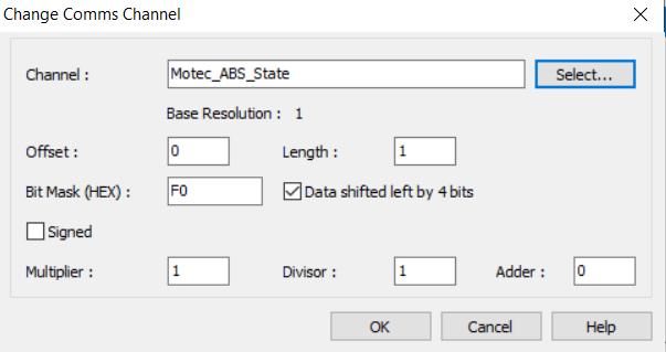

Motec_ABS_State
ABS State.PNG (30.47 KiB) Viewed 3159 times

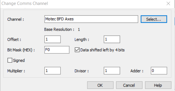

Re: Transmit CAN Message
Postby HMeier on Wed Jun 05, 2024 10:46 pm
Motec_BFD_Axes
BFD Axes.PNG (30.3 KiB) Viewed 3159 times

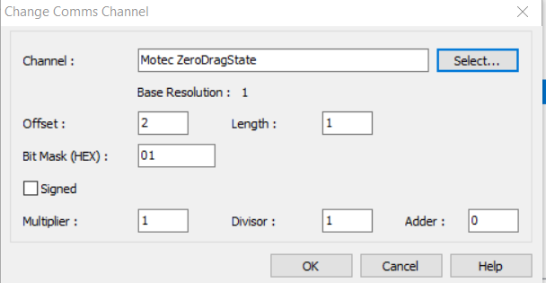

Motec_ZeroDrag
Thank you and best regards
