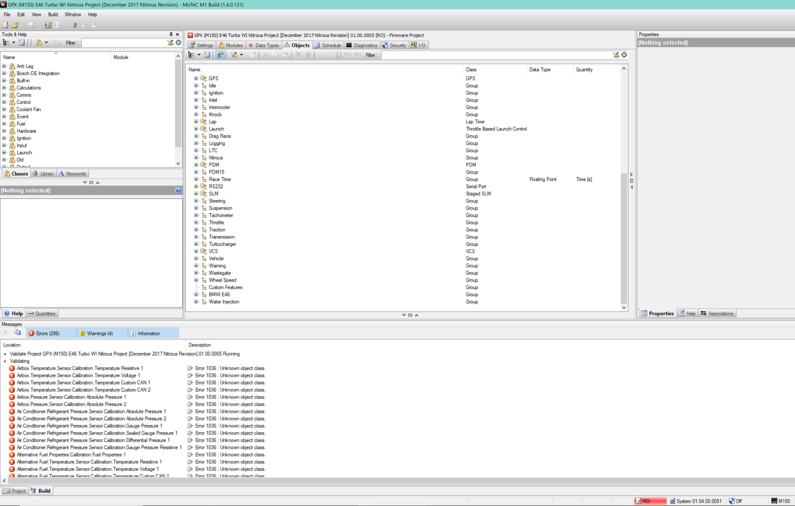

From 2014 to 2017 I developed my own M1 Build project for private use. I started with version 1.3, and upgraded to 1.4.0 when it came out. To give an idea of the amount of progress made, the original Project had under 11,000 objects, and the last version I was running in December 2017 had over 17,000 objects. There is a fair amount of work into this.
Having changed multiple computers, adding the latest version of M1 build to each, I now find that I cannot compile the original project from 2017.
I've since backtracked, installing Build Version 1.4.0.0131 from March 2016, but I get a new set of errors. I've tried a number of the usual tricks, such as manually adjusting Module versions, but I've so far only achieved increases in the number of errors.
Does anyone recognize the below issue, and have a tip to solve it?

There is a symbiosis between the Build Version, the System version, Project base and the Modules in use with in a M1 Build Project. If one of these doesn't line up, or is not compatible with another item, then you will get these errors. What is showing at the moment appears to be that you have a mismatch with the MoTeC Input Module, and one or more of the other Modules and/or the System file that you have chosen.
Unfortunately, there is not a matrix of compatibility for the System and Module files to ease the troubleshooting needed for this, it is a matter of changing one module and rebuilding to see if the issue remains.
I would also do a compare with the last known good Project and see what has changed.

I located a working version of my project on an old computer, with a corresponding version of M1 Build. I was actually fairly far off on the versions...
The trick now will be not to get greedy on feature changes or version updates.
