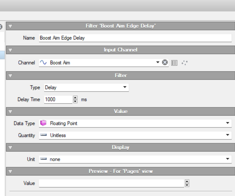

To achieve this you need a condition which is true after the channel value has changed.
The Global Conditions in DC don't have a 'changed by' operator but you can achieve this by using a delay filter. 1000ms seems suitable for the delay time.
delay channel.png (74.81 KiB) Viewed 7980 times
You can reference the source channel and the delay channel in a Global Condition, the global condition will be true when the source channel and delayed channel are NOT the same, I set a result delay here so the overlay will remain active for 2 seconds after the origin channel and delay channel are equal.

Once you have this condition you can configure it as the switch channel for an overlay.
I have attached an example DC project with this all configured for you to take a look at.
