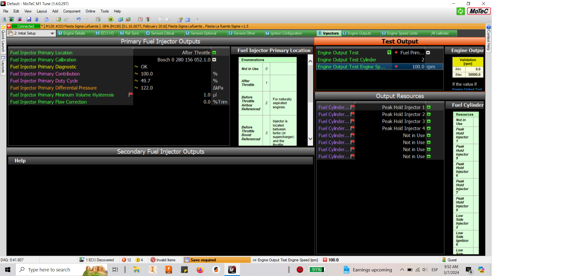

Hi guys, I just watched this two webinars a couple of times now,
https://www.motec.com.au/training/ECU%20Initial%20Setup:%20Ignition%20%26%20Injectors
https://www.motec.com.au/training/Part%206:%20Initial%20Setup%20Workbook%20-%20Injector%20Configuration
and I can't seem to get to test the injectors, I select the fuel primary test, set the injector for #2 and ask for 2000 rpm.
I can't get the injector to physically pulse, I want it to activate it and hear it.
The M1 tune says its all good, I get the diagnostics that pin is ok, injectors are ok, etc etc, but I can't get them to pulse. How do I do that from the M1?

If you try a lower test sped, what happens? Is the Fuel Injector Primary Duty Cycle reporting a value? Are the injectors powered at this time?

Injectors are powered at all times during tests, I will try lower RPM I'm going to the shop where the rally car is today to test again.
I will just leave the package here to share, car use to run fine in all 4 cyl, but from one moment to the other it just started failing in 3cyl, and we can't get the injector #2 to pulse, doesn't even send the pulse to the connector, if we test the connector the ground pulse never comes.
I will have more info later today
GPA (M130) [01.10.0077, February 2016] Fiesta Sigma Lafuente , Fiesta La fuente Sigma v1.m1pkg-archive

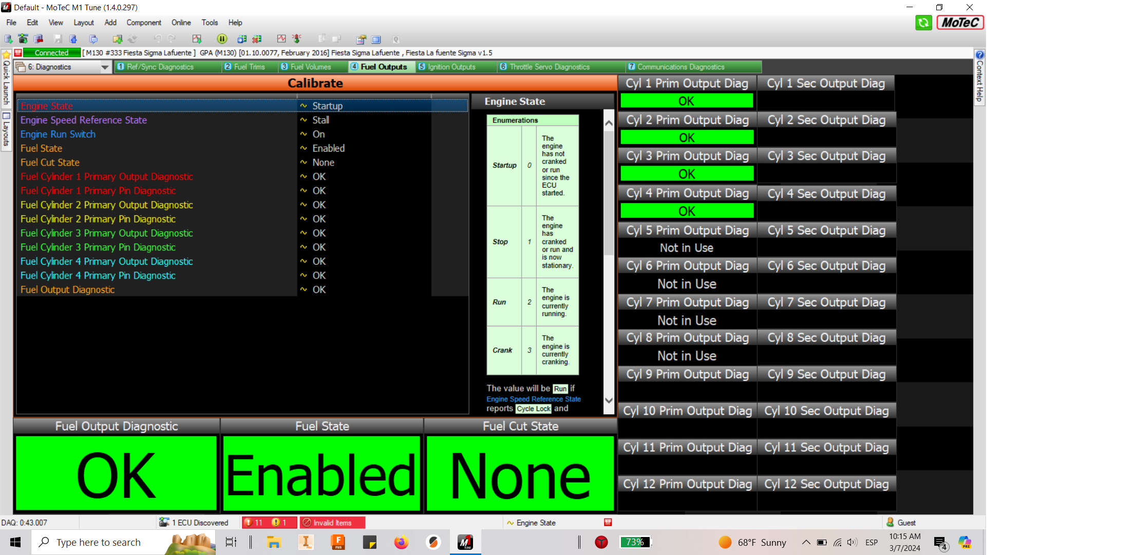

Just adding a screenshot, btw if we disconnect the connectors for any injector, I still get the OK in green for the primary pin diagnostic, that cant be right

I loaded your configuration into and M130 on my test bench and it ran the injector test correctly, using a variety of speeds.
When you run the test, is the Fuel Cylinder x Primary Output Cycle Count incrementing?

Injectors are wired right as far I can tell using a multi-meter and chasing wires, we managed to test it like follows, since cil2 is misfiring, we connected an external injector to the connector, and got it pulsing, so I figured it workings, just doesn't want to work in test mode.
Now I found out that even though its a wasted spark system, its firing right for cil1-4 but the 2-3 is having issues, the #2 coil isn't firing at the right time, which is weird since its supposed to fire at the same time as #3.
This car is making me crazy, diagnostic tests don't give back the right results yet stuff seems to fail.
