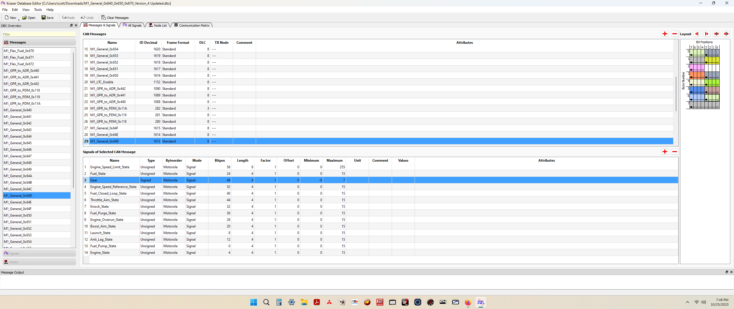

Once again I am stumped on a can related item.. I have been trying to use the can signal from the M150 to the PDM to trigger the reverse lights as the mechanical switch on the trans is not an option with the sequential dog box set up.. I do have a gear sensor on the box, and its wired into the M150 with the information going to the C125. So I know what gear the car is in on the dash. I would like to use that signal to trigger the reverse lights if at all possible..
I have been searching this forum for a while trying to see if anyone had some ideas on how to do this. I downloaded the M150 general DBC and opened it in a program from Kvaser. The format does not make sense to me as this is not really my strong suit.
I see the signal that is on 0x64D bitpos 48, length 4,factor 1,offset 0,minimum -8,maximum 7
how do i use this in something the pdm will understand??
