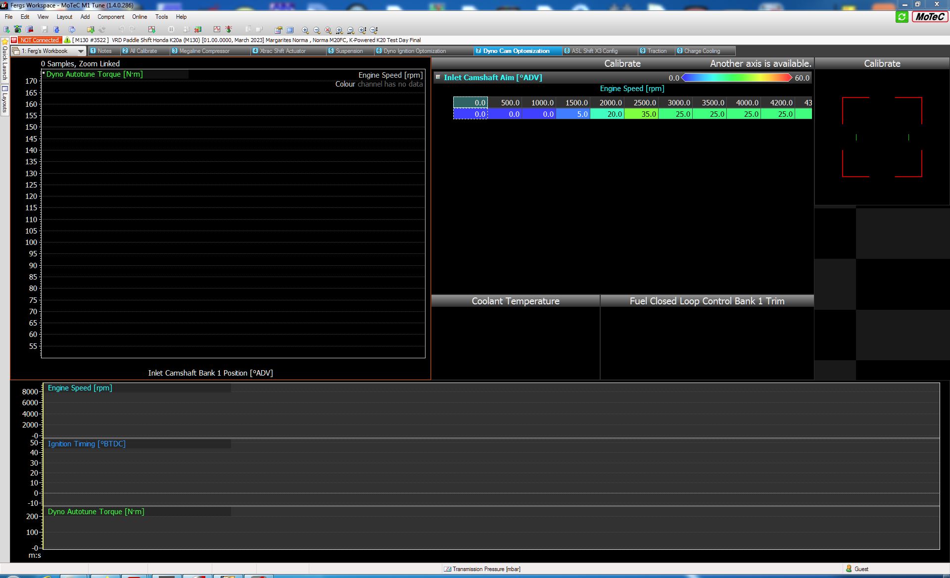

Then you create a worksheet with a scatter plot, and the channels you want to monitor / modify. Now you can hold the engine in a single cell, and change the Ignition timing, or inlet cam aim. Here is a worksheet showing that:

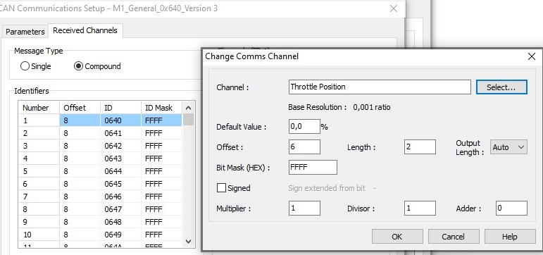

As an example I'd like to set up the Dynapack to read the TPS position from the M1. The TPS is configured as shown in this first picture.

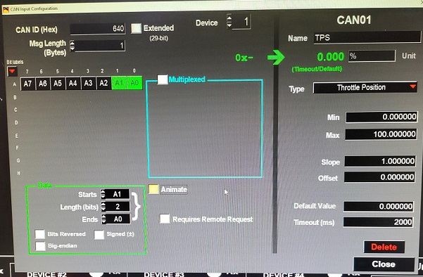

Then I'd like to get an advice on how to set this up in the Dynapack CAN configuration display, shown in the next picture.

The first problem on the Dynapack CAN setup, is the message length os 0x640 is 8 bytes, not just 1 byte. The TPS data is found at offset 6 and is two bytes (16 bits) long (so rows G & H on the Dynapack data grid).
To give you a good starting point, here is a Dynapack CAN Configuration you can just Load. This is based on using the DBC import facility with the M1 DBC file (I will attach the one I used as well -- newer version probably available search this forum). This also has the CAN output configured as I explained above.

It helped realizing that the cells in the Dynapack config represented bits and not bytes. :-)
