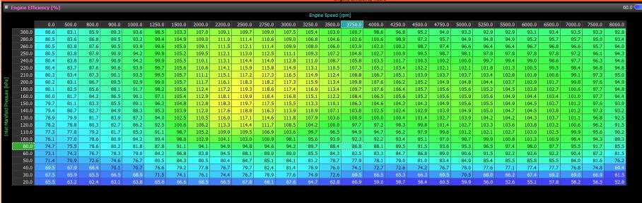

If you are re calibrating the 100% throttle column at 30kpa of boost, I would expect the value to be 130-140. That's because the estimate table is not VE - it is the estimated/calculated/expected manifold pressure for that throttle opening/engine speed. These numbers are representative KPA of manifold pressure.
Your VE is set as 100% - You have the VE set as a single value.
So if you think of it in a normal calibration where manifold pressure is the load source your table looks like this (GTR efficiency table)
Efficiency table.jpg (1.09 MiB) Viewed 7509 times

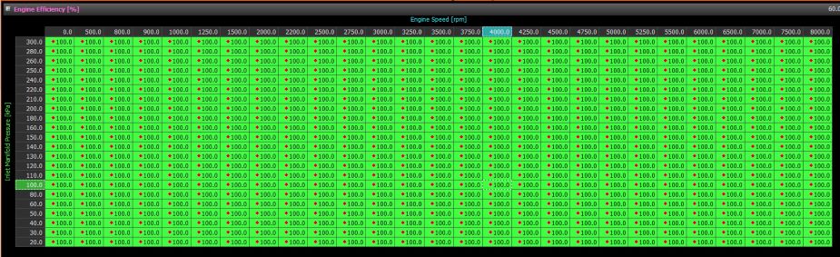

What your table in effect looks like before with 0% in the efficiency compensation boost table is this:
100% VE.jpg (1.32 MiB) Viewed 7509 times

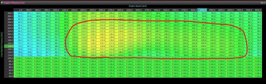

Now if we go back to the start file, and look at the engine efficiency above 100kpa, we have the following:
Eff compensation.jpg (1.21 MiB) Viewed 7509 times

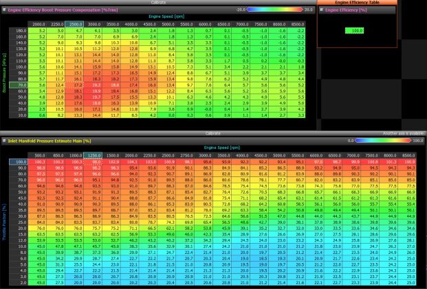

These numbers are above 100%. Not by much, we have numbers just shy of 120% VE. at the high RPM/load areas the engine has lower VE due to exhaust back pressure, but in the mid range where there is cam overlap etc the VE numbers are higher.
Now if we were to combine the changes in VE from 100% vs manifold pressure, our efficiency boost comp table would look something like this:
estimate table with boost pressure comp.jpg (763.17 KiB) Viewed 7509 times
