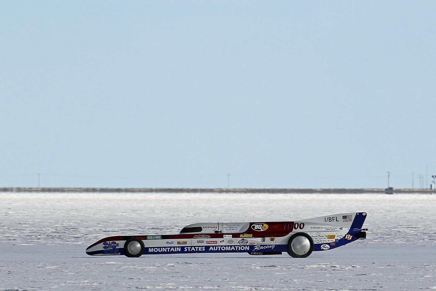

This is a Bonneville motor, not a street motor... I'm not really looking for boost throttle response or lag... we basically push the throttle down shift a little early in 1st gear and be at WOT before the 2nd to 3rd shift. From there it is WFO for the next 4.5 miles or so and shifting with the light.
Best timed mile so far is 248.8 MPH or 400.4 KPH... not bad for 997cc in an open wheel car
