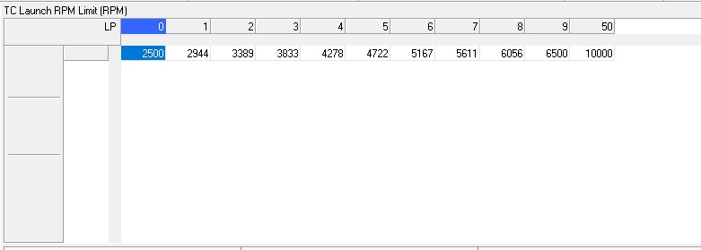

Your launch control has been nagging at me (and I couldn't help myself) so I got out a wiring harness , M800 and a few bits and did some testing.
If the TC disable switch is wired with the transbrake as we think, yes it will work, it will turn off the TC system and the engine will rev to high limit. It doesn't leave launch mode as far as I can see, just turns the TC system off. Needs to power cycle or reset the ecu to leave launch mode once it's entered.
In the supplied configuration, launch control activates only in dial setting 0 and 1 ONLY. This is because to activate the channel value (in this case dial setting) has to be below 1/4 of the maximum value. The reason 2 isn't accessible I believe is because 9/4=2.25, which rounds to 2. 2 = 2 so it's not below.
To access all the settings in the launch rpm table you can do a mod to the table, adding a value of 50 as the last value. 50/4=12.5, which rounds to 12, which is greater than 9.
Kev table mod.jpg (23.71 KiB) Viewed 8086 times
