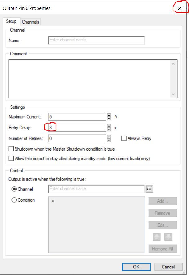

Hi
On one of my pc's, I can't edit properties of ex. the output pin.
The main window works fine, but not any of the properties windows.
In ex. output pin the only box can be edited is "Retry Delay"
Even OK og Cancel button doesn't work.
Anyone who has a fix for that.
BR.
Brian

Postby larsendk on Wed Mar 09, 2022 8:53 am
Thanks for your replies.
I'm pretty sure it has nothing to do with the config file.
I'v tried to open PDM manager "offline" and create a new file.
And with a new config file, the problem is the same.
I'v also created a new user profile on the pc, but still the same.
I know the problem is my pc. (Win 10)
But if you have any inputs, or maybe seen it before.
The attached image is the property of an output, on af new config file.
I can only write in the "Retry Delay" box.
And only select the "Close window" (X)
On the main screen, everything works just fine.
BR.
Brian

Re: PDM Manager 1.9.1.0050
Postby adrian on Wed Mar 09, 2022 9:05 am
Do you happen to use comma's as decimal separators? If so this is a known issue and if you upgrade the latest beta version on our website it has been fixed.
Postby larsendk on Thu Mar 10, 2022 1:44 am
Thanks Adrian
You are a life saver :-)
Yes, it was the problem with the seperator.
I will try the beta version, and change my seperator back to comma.
Have a nice day.
BR.
Brian
