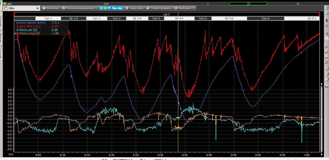

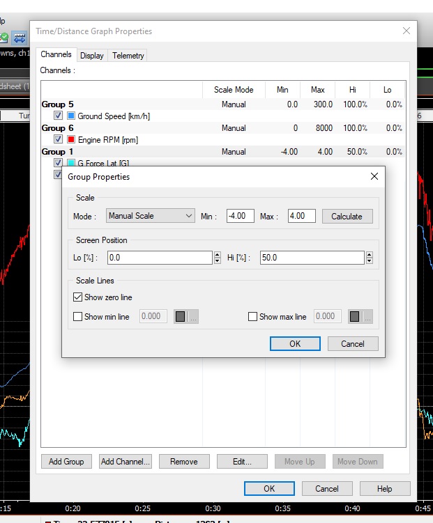

Under the menu > component > properties (F5 hotkey) you will find the menu as in the picture. Firstly, under the display tab select overlapped (at the top left of the dialog box) to display all the channels in one graph.
Then, under the channels tab, you can edit how the channels are displayed. Highlight a group and select edit from the bottom of the properties window. If you choose manual scale you can set the scaling of each group, and the screen position percentage is how much of the screen is used to display the scale you've set. The screenshot of the properties dialog box results in the second screen shot of the sample data. Basically you can use the scale to display the range you want to see and you can use the screen percentage to set how much of the window each group uses, and move it up and down the window.
