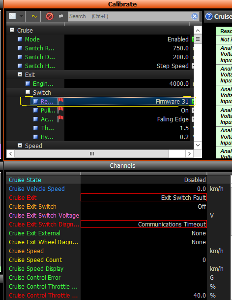

Postby rayhall on Tue Dec 14, 2021 10:24 am
Firmware 31 dose not help
I get a communications timeout error
CruiseControl Settings.png (49.81 KiB) Viewed 6146 times

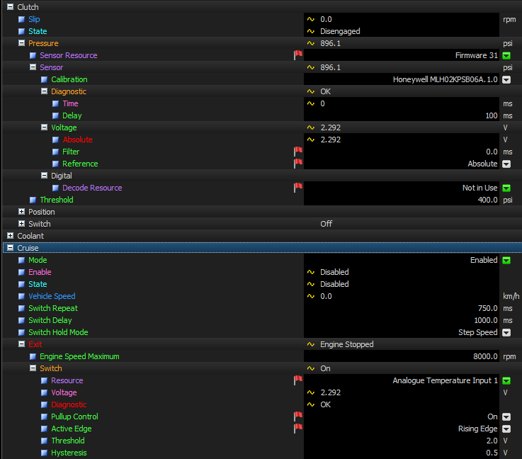

Postby Stephen Dean on Tue Dec 14, 2021 11:13 am
Hi Ray,
Set the Clutch Pressure Sensor Resource to Firmware 31, and move the input that was used for Clutch Pressure Sensor Resource to the Cruise Exit Switch Resource.
Cruise Control setup.PNG (46.34 KiB) Viewed 6140 times

Postby rayhall on Tue Dec 14, 2021 11:31 am
Stephen,
Brad when on line to my laptop and set it all up and checked it all works.
Thank you.
Ray.
