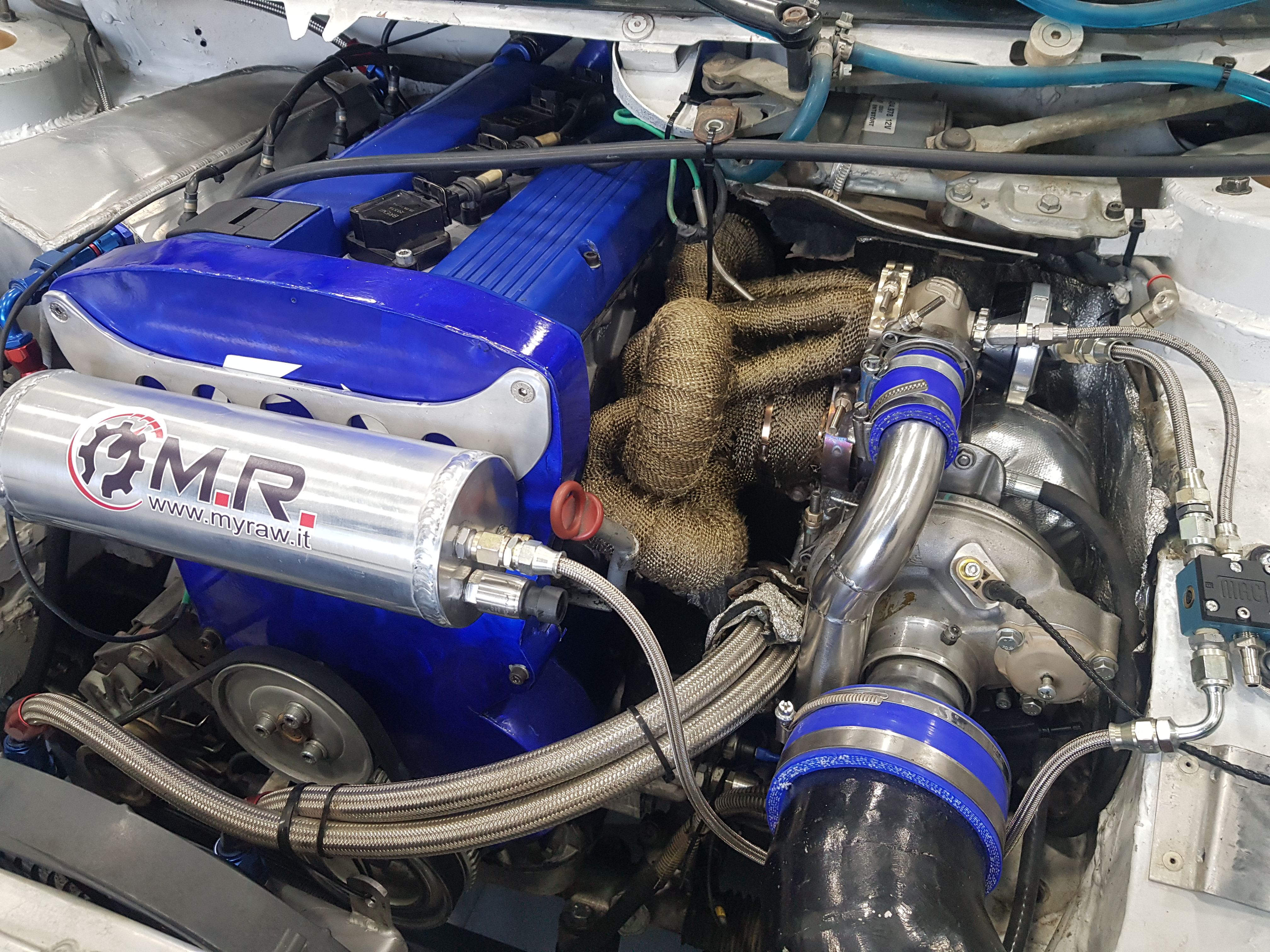

Postby MyRaw on Wed Oct 13, 2021 6:36 pm
I am attaching a current photo.
4 cylinder engine
turbo Borg warner efr 7163
valve for als turbosmart avl 40 with 20mm inlet air passage.
With the classic anti lag I kept the throttle 25 ° open .. with this system I will have to keep it open? or can the opening be reduced?
Als strategy:
-40 ° ignition delay
ignition cut-off 40%
fuel enrichment 30%.
I tried to move from these values ​​but to no avail.
I have a pressure sensor before and after the throttle.
I have an exhaust gas temperature sensor.
I have the turbo rpm sensor.
If you tell me specifically the data you need, I'll give them to you.
for now thanks for the advice
