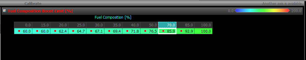

I want to adjust the aim boost levels based off the flexfuel sensor %ethanol. How do I achieve this?

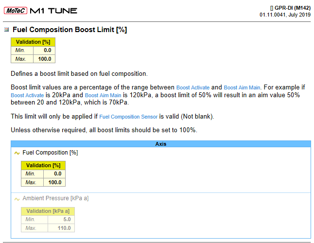

You need to have the alternate fuel mode set to flex fuel, and have a boost output resource assigned to add all the boost control systems.
You are then looking for the 'fuel composition boost limit (%)" table.
This applies a scaling between the boost activate and boost aim main.
As this table has a maximum value of 100%, you set you boost aim table to suit your higher boost fuel (high ethanol content) and use the table to scale down for your lower octane fuel settings.

Hi Nathan,
Excellent, thanks for this information, all sorted.
