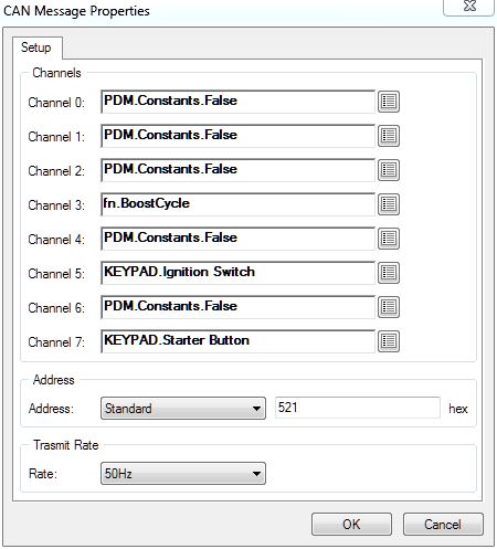

OK, so this is a little tricky to do with a PDM vs. an ADL, but still possible. I figured this out from this thread:
viewtopic.php?f=13&t=3890
The "ADL Receive" is expecting a Compound Message on that address. The first Compound Message will have 00 00 in the first two bytes, and then it reads the 16 bits values ADL 1, ADL 2, ADL2 from the following bytes.
So configure the M800 to receive ADL 1.
Then Configure the CAN transmit on the PDM to send to necessary CAN address, the following bytes: 0, 0, 0, BoostLevel,0, <ADL2 value>, 0, <ADL 3 value>.
I am attaching a picture showing this configured in the PDM CAN message window
CAN message for 0x521
PDM CAN Message.JPG (49.1 KiB) Viewed 12377 times
Re: PDM/Keypad CAN-output to M800
Postby cotje on Wed Apr 14, 2021 8:16 am
Aha, that starts making sense, knowing know it maps out differtly explains the weird values.
I just confirmed, with the CAN-utility, the PDM is putting out the correct channel values.
That link you referenced is exaclty what I used to get the CDL3 GPS speed into the M800 (for launch control). Question now is if I can combine the CDL3 input with the PDM input on the M800... being both ADL1
Will try and report back. Thanks again David!
