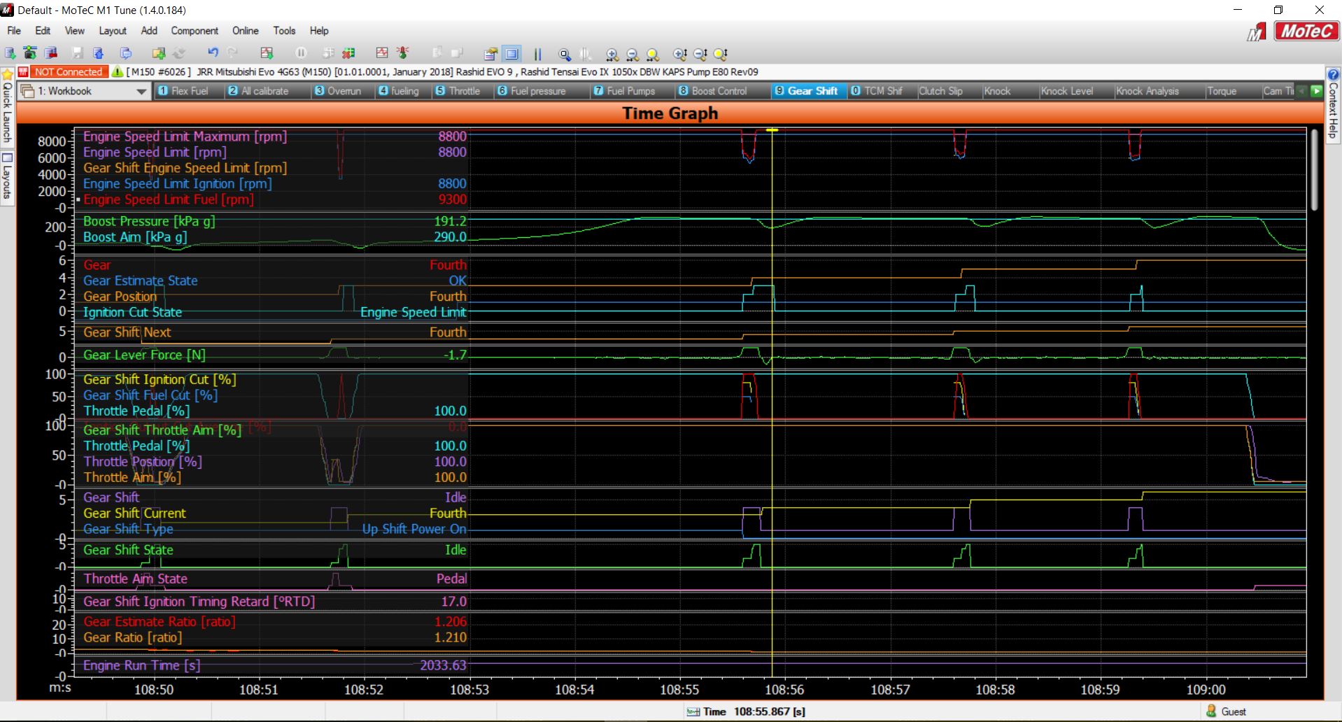

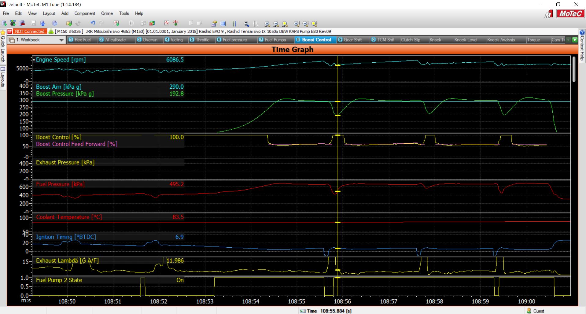

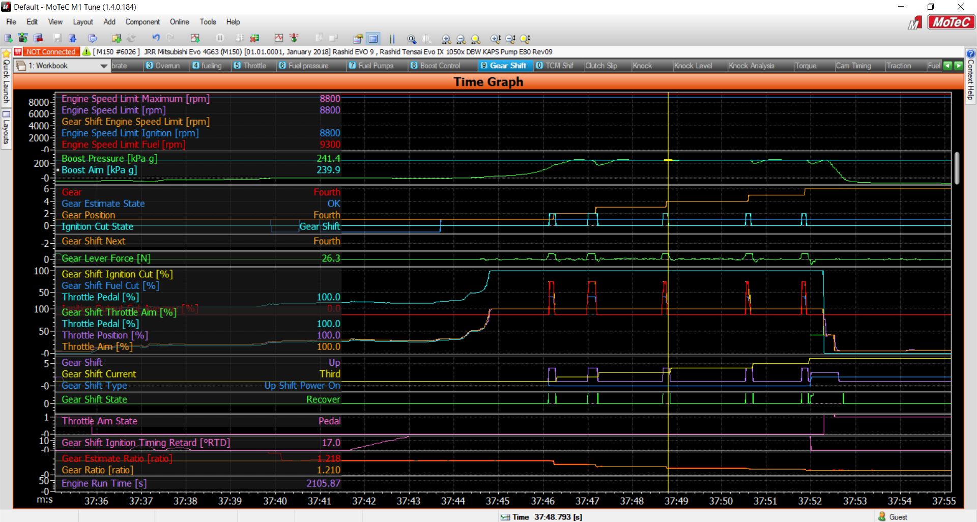

Car is Evo IX, running M150 with JRR 4g63 custom package. KAPS sequential 6 speed transmission.
i am facing a problem of Boost Pressure drop around 1 Bar after shift. its very annoying.
i have sucessfuly setup a Subaru STI last year, the boost was stable (actually most people complain about boost spike between shift!).
can you please have a look at the log, and any ideas how to get boost stable?

Looking at the screen captures it looks to me like the M1 is trying to maintain boost (Boost Aim doesn't drop, Boost Control goes to 100% which should be building boost) when the Boost Pressure is being bleed off. Is the BOV opening at the time? as it looks to me like there has been an external vent of boost pressure causing the Boost Pressure to drop, rather than the M1 commanding a drop of Boost Pressure.

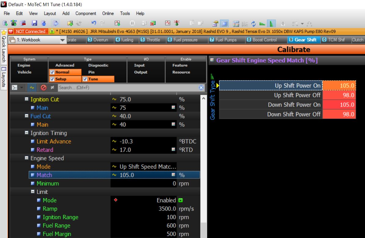

throttle is firm at 100%, and there is no way BOV (Tial Sport) will open without seeing Vacuum. I am sure.
i think i found out what is the problem. surprisingly, the "Gear Shift Speed Limit" option, was the reason. settings maybe!
this option, was imposing a 100% ignition cut, and 100% fuel cut, because the engine speed limit was targeting to match the next gear RPM.
i think the cut amount and length to bring the RPM to the next gear match, was too much and too long, that the engine exhaust gas was not enough to maintain turbo rotation to achieve boost.
i found out that car was not following the Ignition Cut, Fuel Cut in the gear Shift tables, but following the Rev Limit settings of next gear.
as you can see, we i switch off the Engine Speed Matching, the drop is minimum and sometime no drop at all.
thanks for your attention

I looked through some of the logging that i have from my car, and others that have M1's and use the Gear Shift function and none showed the same boost drop that you have, with most of them remaining at Boost Aim, even with large amounts of fuel and ignition cut. None of the logging that I looked at had 100% cut for both fuel and ignition, so it may be that that combination causes the turbo to drop so quickly.

I have experienced boost drop due to gear shift ignition cut events and it's just from the loss of hot exhaust flow, but yours is a lot of boost gone. I suspect the fuel cut is more to blame as it might take a few extra revs to re-establish fuel film and start firing properly again.
You could try using the gear shift rev matching feature just with the fuel margin pushed well out of the way (ignition cut rev limiter only).
We have experimented with gear shift rev matching using ignition retard with very good results. This will build boost on shifts, but it can be balanced with ignition cut also making boost control on shifts reasonably tuneable.
