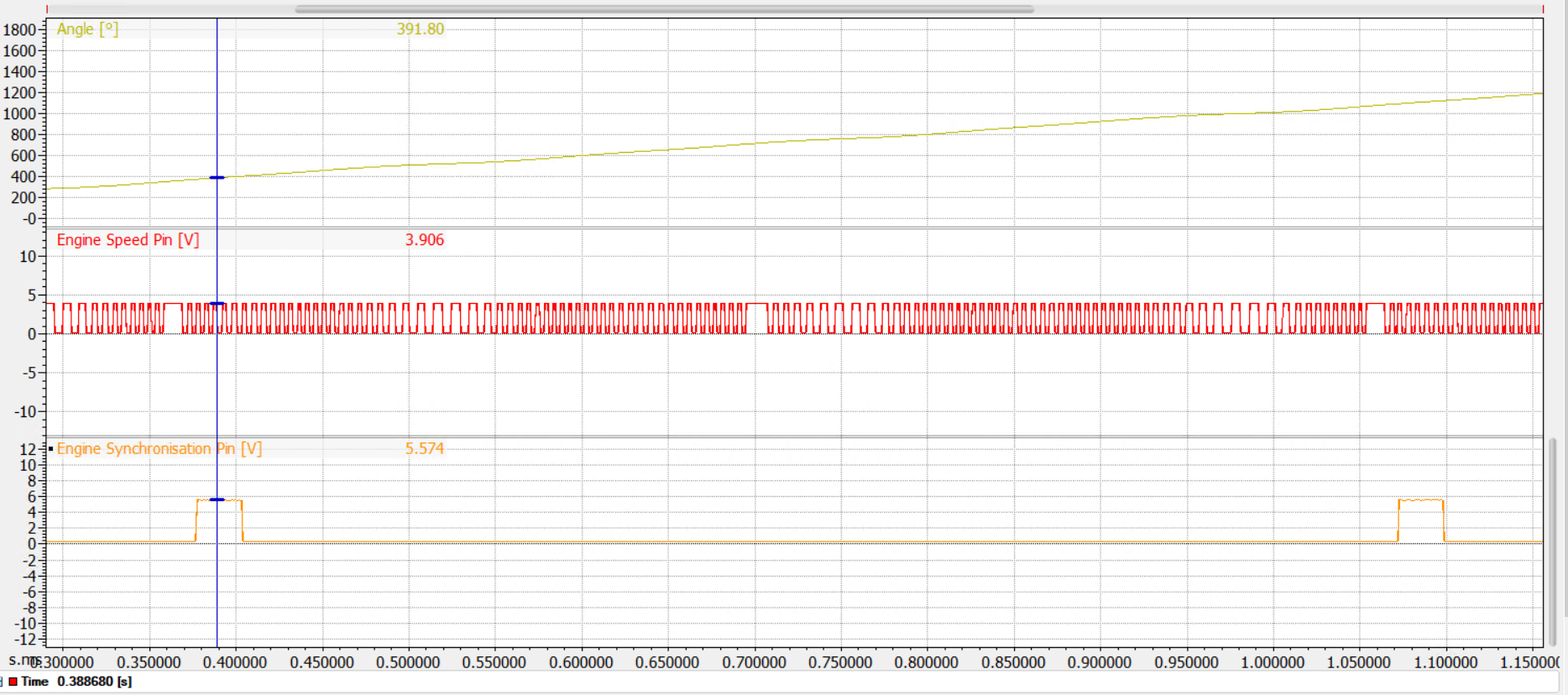

Hi all
How does my Engine position and reference wave forms look?

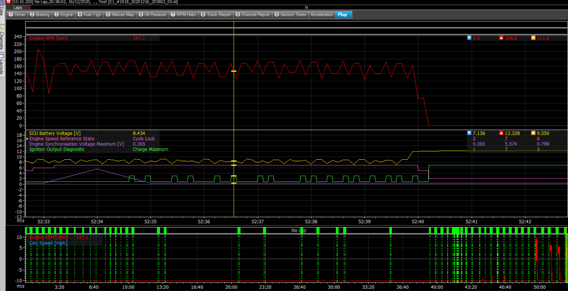

ECU view -
Gregs first turnover

Postby Stephen Dean on Mon Dec 14, 2020 9:17 am
The Pullups should be on for Hall Effect sensors.

Postby AlanB on Mon Dec 14, 2020 8:46 pm
Also, the Hysteresis for ref and sync should be a fixed value for hall effect sensors. I would suggest 1V.

Postby greenamex2 on Mon Dec 14, 2020 8:51 pm
Thanks all, that is lunch times task.
Is the fact that the speed trace is "inverted" an issue?
I have ordered a sensor to match the reference one but just interested (especially if I need to use a wheel speed sensor in an emergency!).

Postby AlanB on Mon Dec 14, 2020 8:54 pm
Both ref and sync traces look fine.
