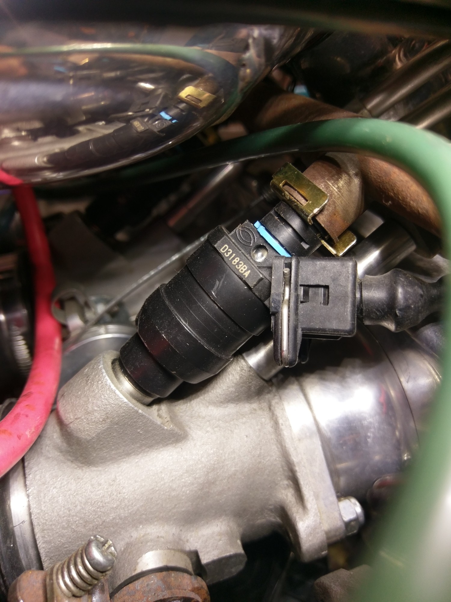

And next,
Does anyone know what injectors these are
Number on them is D3183BA.
Cheers SRR

Re: Suzuki GSX 1100 Best trigger wheel to use
Postby Stephen Dean on Mon Aug 17, 2020 12:27 pm
I do not have any information for that injector part number.
