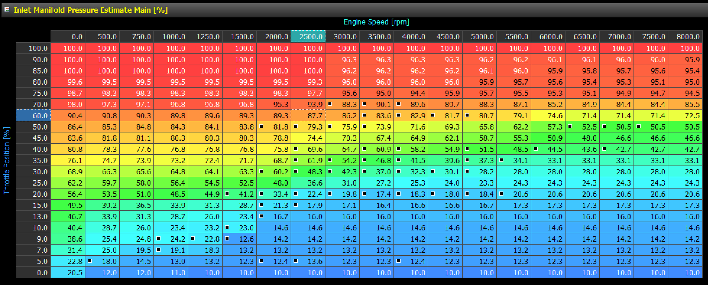

Manifold estimate fuel table.png (124.9 KiB) Viewed 12950 times
When the system is setup in accordance with CTN0036, the fuel table is relative to throttle position.
