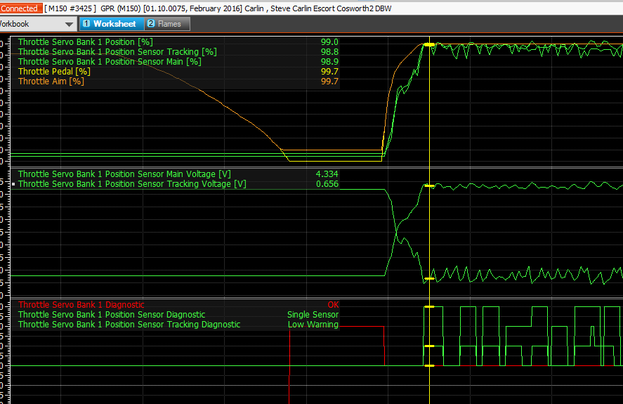

Hey guys
Does anyone know what this error is, i have a second hand throttle body and wondering if its faulty.
using the correct calibration it seems iratic
Sometimes the pedal is pressed and the body does nothing at all
Says single sensor - not sure what that means
dbw issue.png (46.95 KiB) Viewed 13102 times

Postby David Ferguson on Sun Aug 02, 2020 10:38 am
It's not moving, because it's already encountered a "tracking fault" as indicated by Throttle Servo Bank 1 Diagnostic.
The fault remains until the servo becomes inactive (ie, Throttle Pedal is zero for "Throttle Servo Power Save Delay").
Hope that helps. I suggest reading the help in M1 Tune for channels like Throttle Servo Bank 1 Diagnostic.
What channel is reporting "single sensor"? both the Throttle Pedal and the Throttle Postion (on the DBW throttle body or linkage) need to have dual sensors for safety (main & tracking need to agree, or else the ECU doesn't know which to believe and needs to stop activating the throttle.)

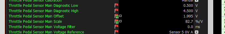

Postby SteveC on Mon Aug 03, 2020 9:23 am
Both voltages have been set (closed, then Q and Open then Q)
I did just that changed back to manual and left it at that - all the settings were the same.
The more i look at this the more i think the Feed Forward table isnt correct but before i go down that path i am not sure if its settings or body fault.

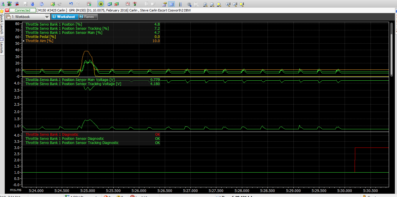

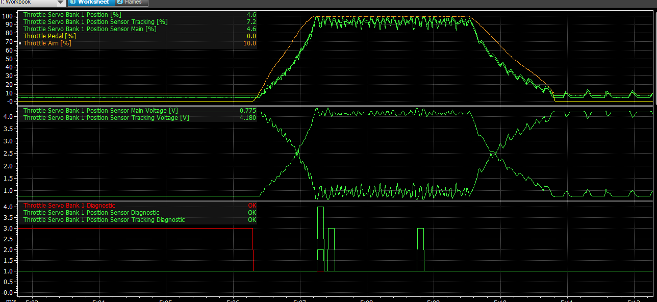

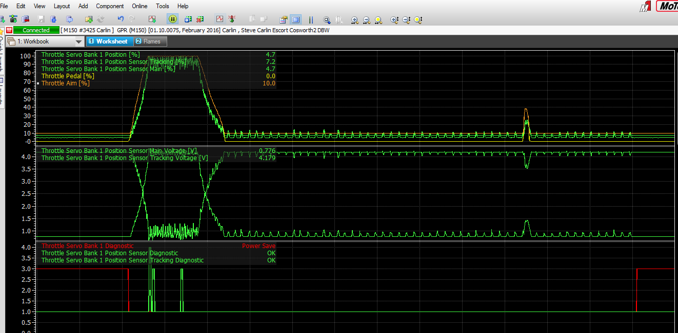

Postby Stephen Dean on Tue Aug 04, 2020 2:18 pm
That is the calibration for the 151 DBW.
That you have a regular pulse opening the servo that isn't commanded by the pedal looks to either be a setting issue or a faulty servo. Can you reset the DBW setting back to what is listed above and then do some more captures showing the P,I and D channels, as well as the Feed Forward and Control channels.
If you could post your Package that would assist as well.
