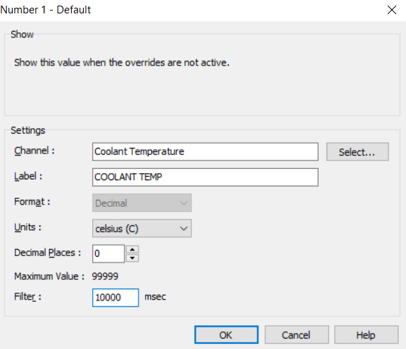

Hello.,
Is there any Filter option for the channels when we use Display Creator for the Dash.,
Because when i try by using Dash Manager there is Filter option for the Channels,
But when i use Display Creator there is not.,
i see Frames/Sec option but it is not working good for me.,
please let me know how to solve it.,
Display Creator
Dash Manager

Are you talking about filtering the actual channel value?
If so, in DC go to the "Channels and Functions" tab and select a new filter. Set the channel you want to filter as the input and adjust the settings as required. You then use the "Filter Value" channel on your Display.
