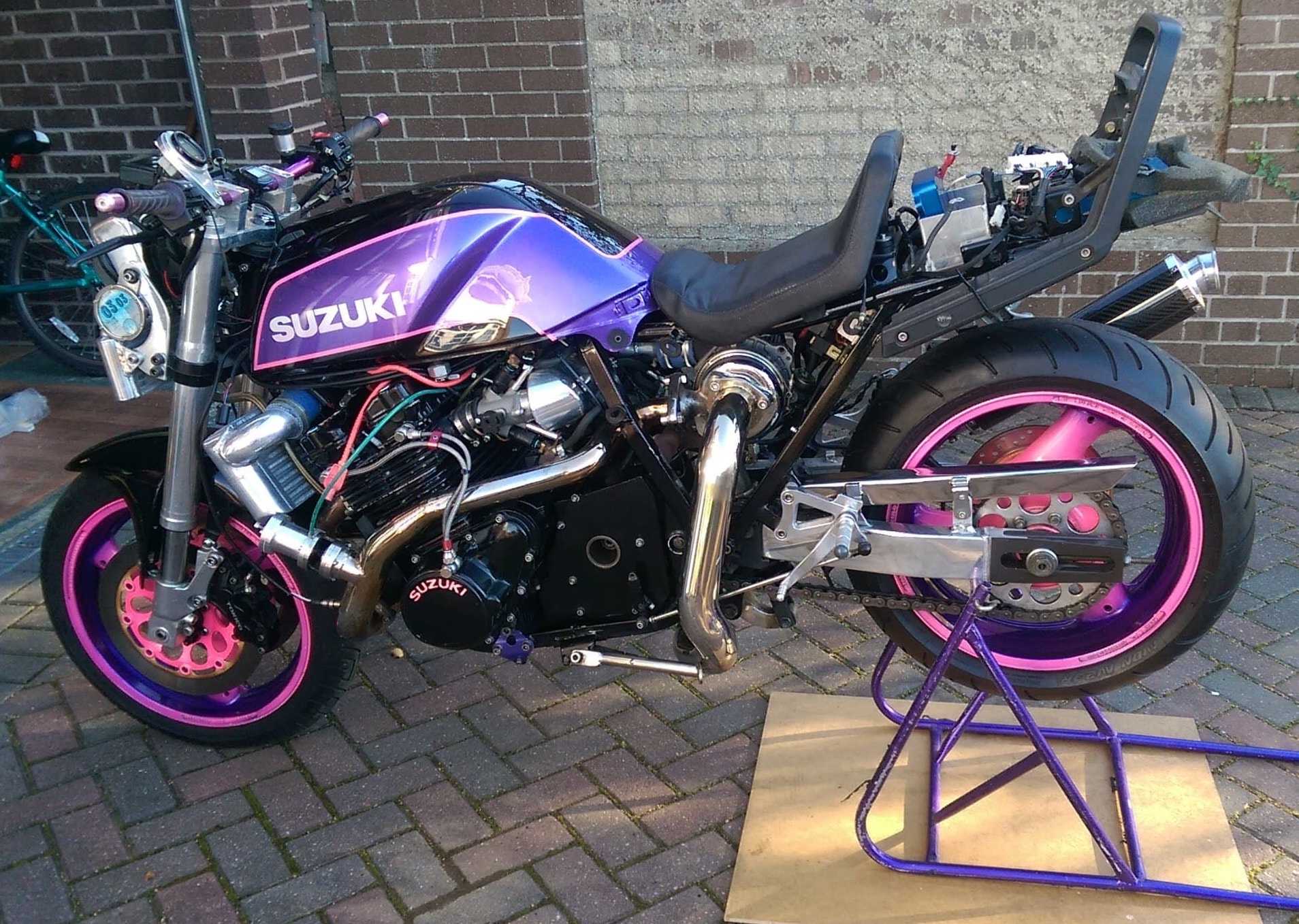

Hi All,
I am hoping to change my current ecu to a M84, but will it run with the existing pickup?
Suzuki GSX 1100 EFE Pickup
If not what would be the best to use, taking into account I have limited space.
Cheers SRR.

There isn't a cam sensor, bike is from 1984 so quite basic.
I have the following information from the existing ecu manufacturer
"At speeds below 700 RPM the ignition timing is fixed to spark on the rising edge of the tooth that precedes the long tooth(slug) (cyls 1/4) and the tooth that follows the slug (cyls 2/3).
From 700 RPM upwards the ignition timing is adjustable."
I could possible fit a cam sensor, but it will be tricky.
Also the pickup to the left of the first picture is the only one being used, the one to the right is disconnected.
The main problems I have are
1. Bike kicks back when trying to start, sometimes undoing the starter clutch.
2. When warm it is hard to restart.
3. When riding and accelerating the bike will not pull boost unless I turn the choke on.
Cheers SRR

Sync sensor on a GSX1100, GT101 reading off a cam lobe. You could use a GSXR sync sensor, but need to check. Some of the GSXR ones have a weird offset signal. What cams do you have in it, generally the aftermarket like Web Cam have fairly pointy lobes.
I'd run a later GSXR trigger and pickup. They're standard EFE pickups on there now?
This bike isn't mine, but I've done a bit of work on it.
Sean
