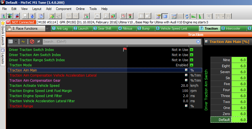

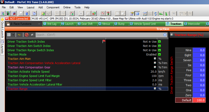

I have watched a few videos on setting up the traction control. When I try to do this on my car many of the settings are missing. Add to this it does not work at all. Here are screen shots on mt setting which are quite limited. I cannot set the cut method, ignition retard or DBW throttle.
Ray.

In the HPA video, starting at 31:50, Andre says that he has added the features for Throttle Control and Ignition Retard using custom firmware, and it is not available in the Production Toyota 86 firmware (nor is it in GPA/GPR).
That is why his screens have additional parameters not shown in the Toyota 86 Package.
All of his comments about setting up the Fuel Margin, Fuel Range and Ignition Range are appropriate to your GPR package.
If your traction control isn't working, the first thing I check is that Engine Speed Limit is tracking the current Engine Speed when the car is driving. If it's not 6% higher, then the gear ratio setup, gear detection, wheel speed calibration isn't correct, or Traction Control isn't enabled for some reason. Too many things for me to guess, but not hard to figure out if you have access to the data logs.

I see that you have two driver switches defined, but there are no functions that are using them that I can see. What is their intended purpose? Normally I use at least one switch as the Ignition (Engine Run) switch.
On the Race Functions->Traction tab, I think you want to set the Driver Traction Switch Index to "Default" instead of "Not in Use". I verified the default setting is ON in the Driver Traction Switch Mapping.
Also, the Traction Range table. You have the default at 100. This is a percentage multiplier, so this effectively makes the ignition range of the cut equal to the Traction Engine Speed LImit -- I believe this is why you don't think this works. Try putting it back to the default value of 0%, to smooth the traction you usea small percentage (ie. like 1 - 5 %)
Is the tire size correct? -- front and rear are the same size (1.94 meter circumference, so 61.7 cm tall). Seems small for a car with a V10. Do you have logged data showing wheel spin? Just want to make sure the front/rear config matches the wiring.
I agree with David, this is likely the #1 culprit.....
