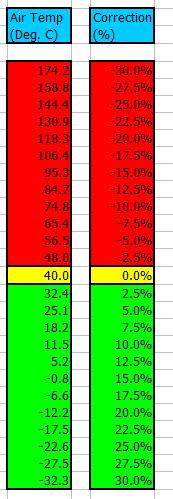

Im surprised that it wants to run that rich. Normally if you lean in out the power will go up? The pistons used were the RA type, supposedly the better ones...please give me your comment. I understand exactly what you mean by the AT ign trim problem. At what temp do you run your 0deg trim? Please look at the attached picture of an IAT calc spreadsheet and what u think of the values. If you want i can get the specific model of the turbo for you. Are there certain ones that are better for restriced applications?
Thanks alot for the other info, ill have it put into the map and try it out. If you have by any chance a map that you are willing to share i would really like to learn from it.

Postby Ben-S on Mon Jul 21, 2008 2:47 pm
The corrections you post a for fuel not timing... see the link for some info on the turbo's you can get away with using in groupn

Yes i know, but what are your comments?
Looks like big trims hey....or am i just too conservative

On any other turbo engine .85 is good for the best power, but on an EJ running big boost they are better with .76 at 250kpa, easiest way to tell is to dyno to what makes the best power, not what you think you should tune to.
IT corection, 20degs =0 30degs= -1, 40= -2 and so on.

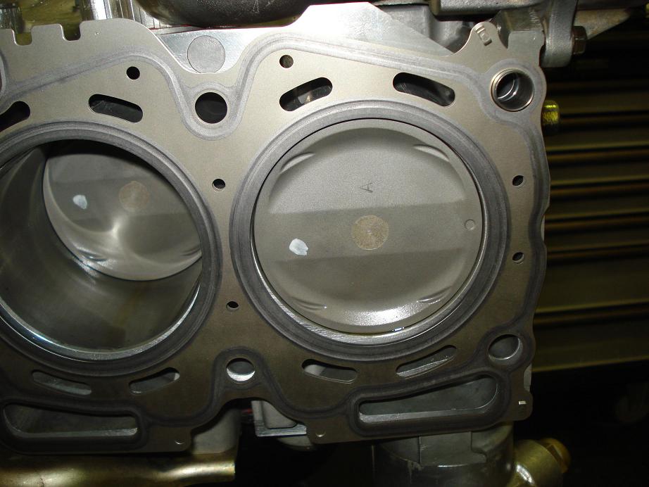

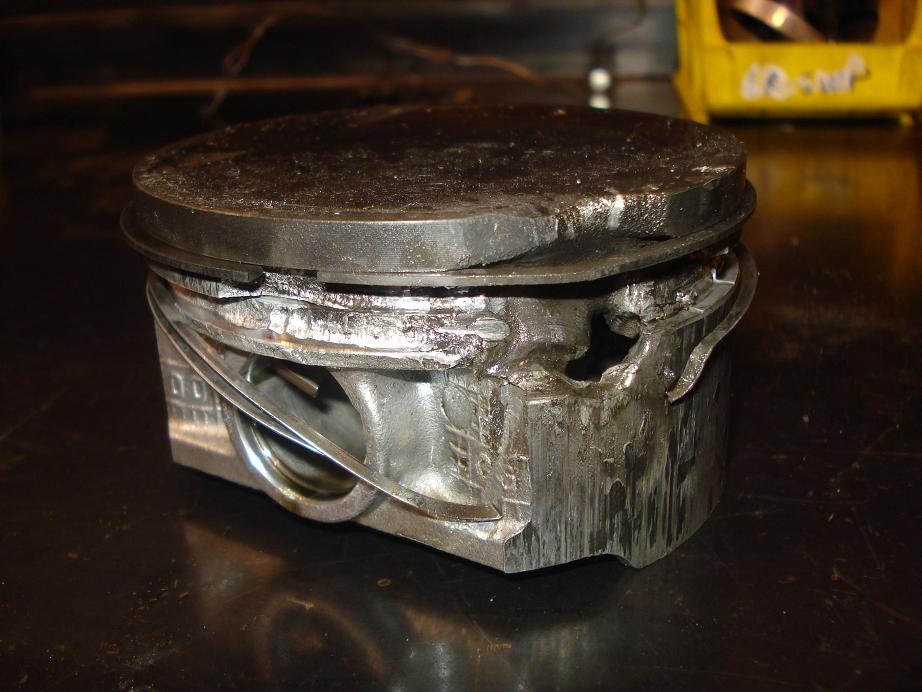

Pictures of the failed parts...
This is piston1.. ( 1 is the first piston on the crankshaft from the crank pully...standing infront of the car looking at the engine, the piston closest to you on the left hand side)
Old engine damaged piston
Old engine damage pistoin
New pistons
