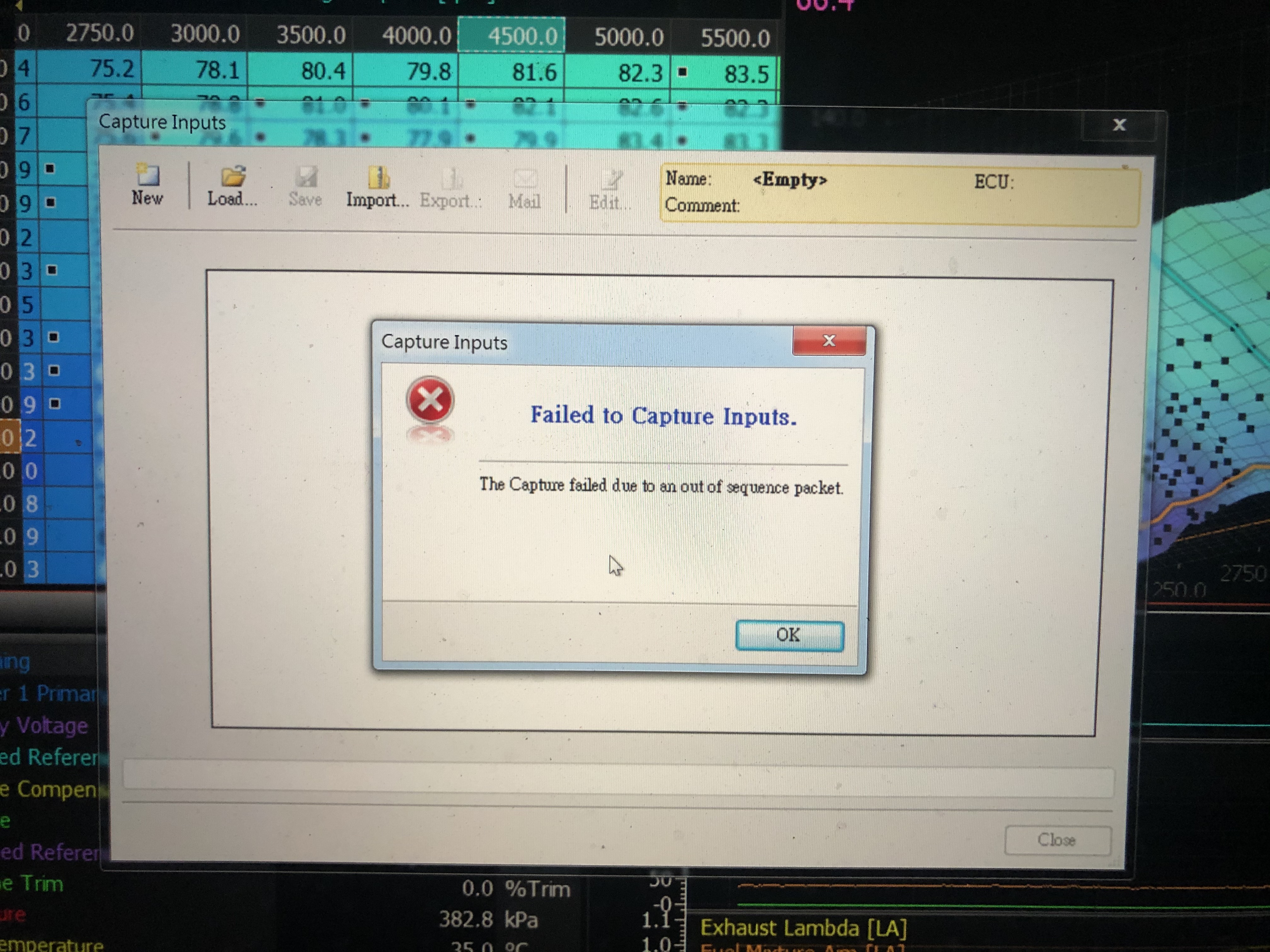

I use capture input in M1 . I meet this problem. Please give me recommendation. Thanks.

Postby Stephen Dean on Tue Feb 04, 2020 10:24 am
Are you directly connected to the M1, or going through a network hub/switch?
This error is normally caused by excessive noise on the Ethernet network, causing a drop out of the message packets between the M1 and computer.
Can you try directly connecting to the M1 and doing the capture again thanks.
