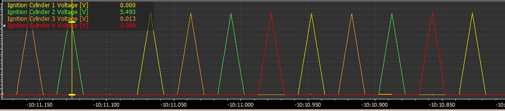

I have a question about Inj and ign voltages logging, as one can see in the picture, those voltages are not constant.
Is that normal please ?

I wouldn't be concerned about the way that the data traces look, as these can be changed a large amount based on the sample rate of the channel.
This is my ignition voltages logged at 100hz when the engine is idling at ~1000rpm. The missing Cyl 4 is because the event happened between sampling points, if I logged the channel at a higher rate I would have most likely have gotten these captured.

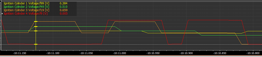

This is the same data with differing filters applied.
Ign Voltages Filtered.PNG (14.35 KiB) Viewed 9453 times
I have filtered Cyl 1 to the equivalent of 1hz logging, Cyl 2 to 2Hz, Cyl 3 to 5Hx and Cyl 4 to 10Hz.
