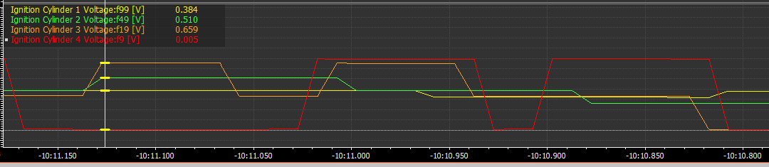

I have a question about Inj and ign voltages logging, as one can see in the picture, those voltages are not constant.
Is that normal please ?
image ign inj volt.PNG (53.14 KiB) Viewed 9460 times

I wouldn't be concerned about the way that the data traces look, as these can be changed a large amount based on the sample rate of the channel.

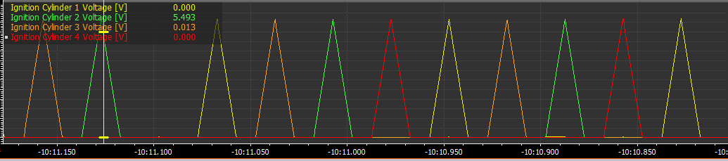

This is my ignition voltages logged at 100hz when the engine is idling at ~1000rpm. The missing Cyl 4 is because the event happened between sampling points, if I logged the channel at a higher rate I would have most likely have gotten these captured.
Ign Voltages.PNG (17.22 KiB) Viewed 9445 times
This is the same data with differing filters applied.
Ign Voltages Filtered.PNG (14.35 KiB) Viewed 9445 times
I have filtered Cyl 1 to the equivalent of 1hz logging, Cyl 2 to 2Hz, Cyl 3 to 5Hx and Cyl 4 to 10Hz.
