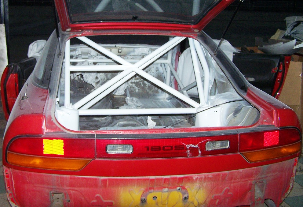

Custom build roll cage.

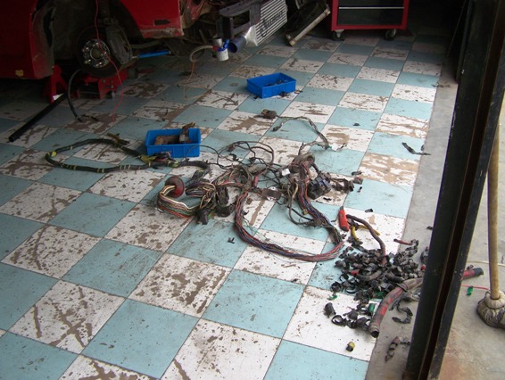

A lot of wiring did kiss the ground and fly into garbage! ECU power, and few other stuff going trough MoTeC PDM 15!

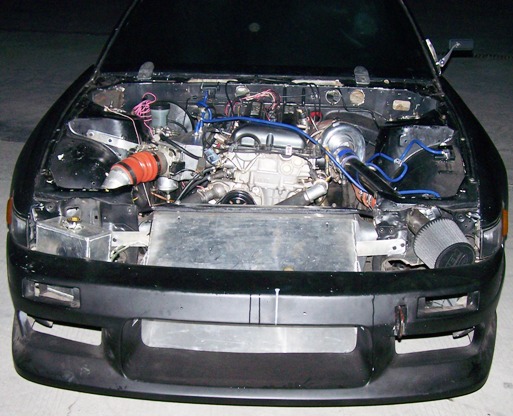

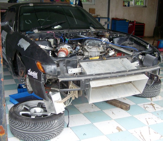

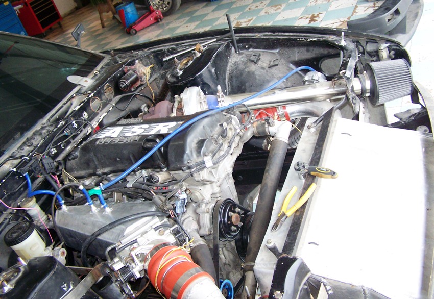

My baby!
Big Aluminum intercooler intake dominates fron nose, so no space for water cooler. It's on the back!
llo ther on the wall, there is my Bosch igniter. Intake manifold, throtle body, exhaust manifold, intercooler and pritty much all is made in Art of Speed Racing.
