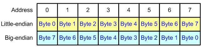

Firstly, the M1 is quite capable of handling either type of CAN messaging (RX and TX), just by setting the endianness flag in the CAN message.
Have a look at the below image to assist with Byte numbering within a CAN message:
Hopefully this helps understand how the numbering works.

I am a little confused.
I was given this by MoTec.

Hi githk,
These images show the exact same thing :)

Hi Ryan,
They are different... :D

My apologies!
I didn't read that very well! :o

If I want to assign Byte7 and Byte 6 as a received channel,what Start bit should I use please? Would it be 0 or 7?

You can try 0, but I think that byte6/7 whould start at bit 48 with length 16.

I think for big endian, Byte 6/7 should start with bit 48.
I was not sure about little endian. This was why I was asking.
