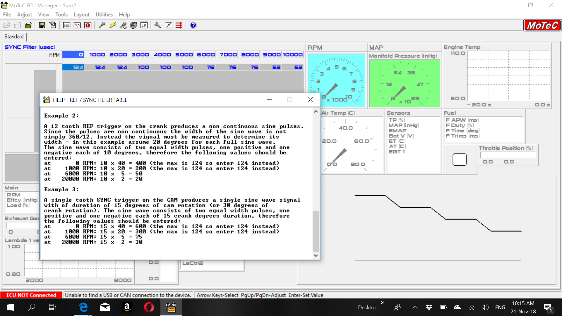

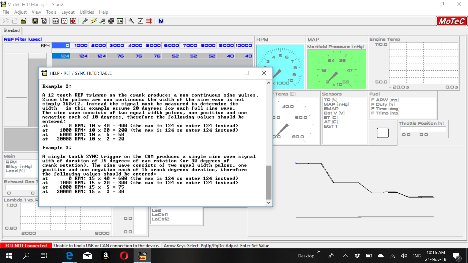

Postby mfalah on Thu Nov 22, 2018 7:07 pm
yeah so using the help page I put the data in there but just asking for opinions is this too much information or this much resolution is just fine?
tell me I am not wrong or else I will correct it.
Sensor used: Hall Effect generic sensorfrom Australia
Ref sync trigger: Ross metal jacket 12 tooth crank and 1 tooth exhaust cam
Engine: RB25
This
That
2018-11-21 (1).png (351.46 KiB) Viewed 11674 times

Postby Stephen Dean on Fri Nov 23, 2018 10:50 am
You do need that many sites for the Filter Tables, start with the recommended values in the help file, and modify them from that point, if needed.
RPM 0 1000 6000 10000
Table 120 60 16 6

Postby Stephen Dean on Wed Jan 30, 2019 10:04 am
Hi Falah,
There are no "one size fits all" numbers for the filter tables and Mag levels, as different engines have different signal output levels. I start with the numbers in the help, and then, based on what the Ref/Sync Capture shows adjust the levels to suit the actual signal being read by the ECU. Most of the time, the standard help numbers will work, and usually just need some small adjustments to the idle voltages as this is where the signal is weakest, once the engine is turning over ~1500rpm, then the strength of the signal is such that the standard values are easily reached.
With the Filter tables, the more teeth that the trigger wheel has, and the faster it turns, the smaller the filter number has to be, if you go to high on these numbers, you will start to filter out valid signals.
