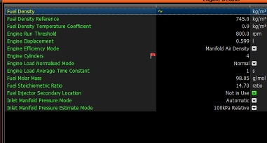

Hi everyone,
Im from a Formula student team and we have just moved to M150 from M800. The team runs a Honda CBR600RR engine with a 2cm restricted intake. We run a Bosch Tmap sensor on the intake and stock denso fuel injectors with Fuel save 98(Shell). While calibrating the engine efficiency table, the values seems to be too high. I do not know what I have done wrong. I feel that the fuel injector calibration maybe wrong because I am not able to find the exact model number on the default options given by M1 for a cbr600rr bike. Could someone help me with this.

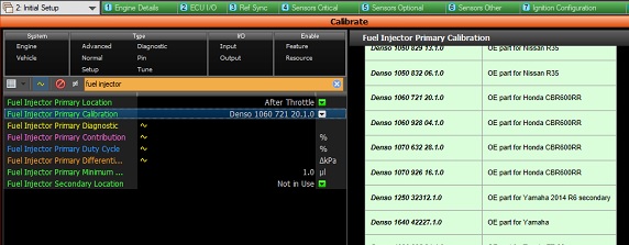

They are just numbers -- if that's what the engine wants then it's OK. It's not unusual to see values like that at particular RPMs where the intake and exhaust resonance produce a pulse that helps stuff more air into the cylinder.
If you want to have your injectors calibrated by MoTeC and added to the M1 pull-down list then you need to arrange to send them in through your MoTeC dealer.
A way to check your injector calibration is to vary the fuel pressure and see if the Lambda output remains constant.
You can also try changing the Fuel Mixture Aim Main and seeing if it achieves the desired mixture (however there are other factors that may cause this not to be correct, including Engine Charge Cooling Gain that you mentioned).
However for calibrating a single engine, that you don't expect to be changing injectors (or if you do, you would revisit the tune), then just building the Efficiency table with what it takes to get a good result will be perfectly fine.
BTW -- telling us what the part number of the injectors you have might allow someone to provide a calibration.

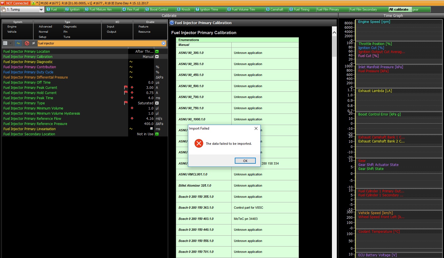

Postby Shivshankar on Wed Feb 28, 2018 1:29 am
Hi Sir,
I have gotten the injectors characterized.However when trying to upload the m1cfg file, it says data failed to be imported. I made a check with the excel file sent along with the m1cfg file and the values seem to match.
May I find out if its okay as long as the numbers match?
The efficiency table was re calibrated with the characterized injectors and the team had track testing over the weekend. Currently, we r using a stock cbr600rr fuel pump. It was seen that the pressure went up to 356kpa. However, before the characterization fuel pressure used to be 330kpa. May I find out if characterization of the injectors causes the pressure in the rail to change ?
I am not sure if whether would play a role in this but it has been hot throughout our testing days.
