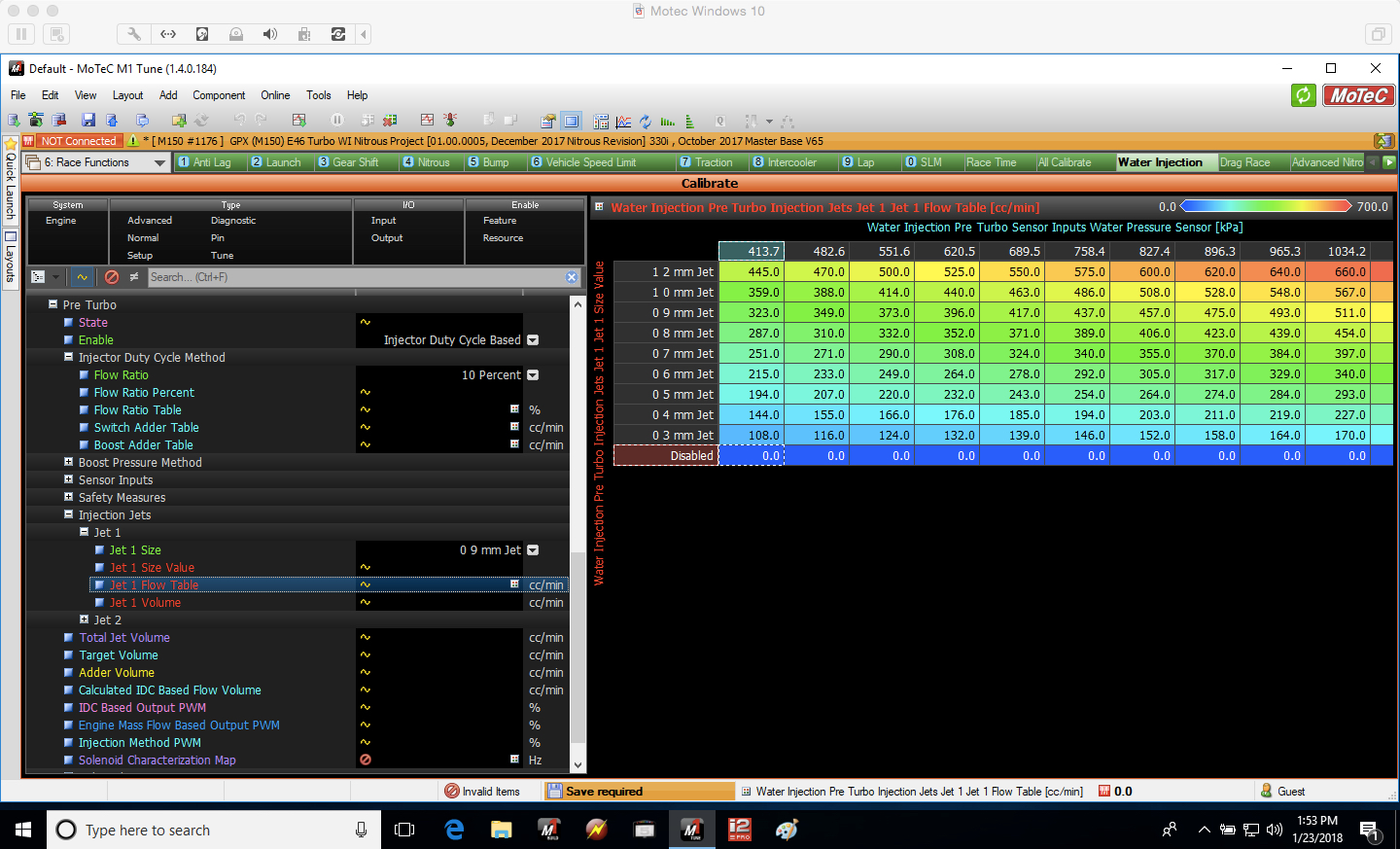

I have both pre turbo and manifold injection, and I have done this 3 different ways so far:
Option 1:) Use one or 2 of the Generic Auxiliary outputs
Option 2.) Re-write the Auxilary outputs to define features exactly as you want with a development license
Option 3.) Write a complete stand-alone strategy with a development license
You can control flow control valves from Aquamist directly from the ECU, but you'll need to use an SSR if you are pulsing the pressure pump. (Not ideal in my opinion)
Attached is an example of Option 3
Motec M1 Custom Water Meth Example.jpg (1006.54 KiB) Viewed 7297 times

MalcolmG wrote:I think that Water Injection Pre Turbo Injection Jets Jet 1 Jet 1 Flow Table is probably the longest name I've seen on any object in M1, and I really hope you've never had to type it all out to reference it from another group in Build :lol:
It is referenced, but it's a lot easier when you're using functions inside of that tree.
