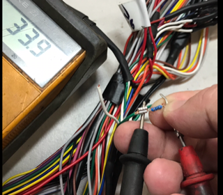

Been supplied the 62207 unterminated loom for this current install,
And cannot seem to find any data or schematics on it, so have pretty much belled the whole thing anyways.
Interestingly the CAN connectors have approx 36 ohms across the comms pins would this be considered a terminated end?
Cheers
TUF-427

As for the CAN wiring, are you measuring 36ohms with the ECU plugged in? The loom doesn't have a CAN resistor in it so with it disconnected you should get open circuit.

Double checked and it has 34ohms across can hi-lo, green and white on connector B17-18 with nothing connected..

Ok if it has 36ohms across CAN Hi and Lo with no devices connected then it sounds like you have 3 100ohm resistors on the bus. You should probably remove one.

Found the pre installed resistor in the loom, marked 100ohm but measures 34ohm even clipped away.

Its a bit hard to see from the image, can you please confirm that the colour bands on that resistor are brown - black - black - black - brown.
I've never seen a resistor measure that far away from the marked value before, just one thing, you don't happen to have a near flat battery in the multimeter?

adrian wrote:Its a bit hard to see from the image, can you please confirm that the colour bands on that resistor are brown - black - black - black - brown.
Yep she’s Brown-Black-Black-Black-Brown should be 100R 1%.
Checked with another meter also, changed out all good.
