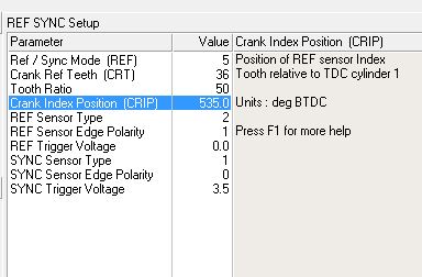

So i have now a REF signal
I also have a sync signal
i have got a CRIP which i believe to be correct
the injector and Coil are not cycling.

by Matek0012 on Mon Dec 18, 2017 5:09 pm
the cript is 360 deg out because it is to the next TDC of compression
Sorry that number has since been changed to 175 deg

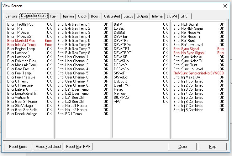

by Matek0012 on Tue Dec 19, 2017 11:49 am
updating the latest capture
But i am still getting an error regarding the rev/sync not being synced
im also not getting ANY pulses to the injector or to the coil

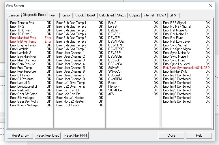

by Matek0012 on Tue Dec 19, 2017 11:54 am
And now this has just happened
