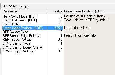

So i have now a REF signal
I also have a sync signal
i have got a CRIP which i believe to be correct
the injector and Coil are not cycling.

Postby Matek0012 on Mon Dec 18, 2017 5:09 pm
the cript is 360 deg out because it is to the next TDC of compression
Sorry that number has since been changed to 175 deg

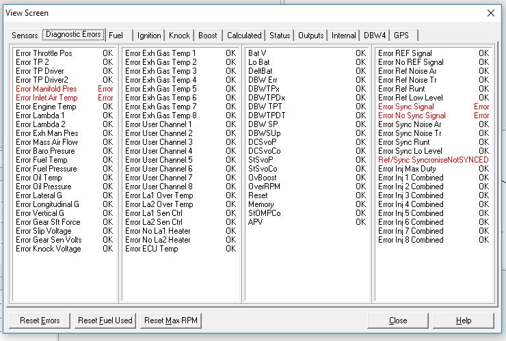

updating the latest capture
But i am still getting an error regarding the rev/sync not being synced
im also not getting ANY pulses to the injector or to the coil

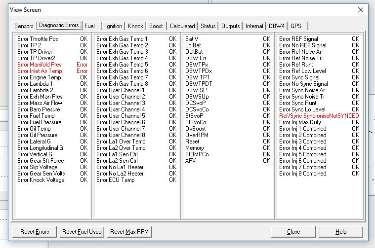

Postby Matek0012 on Tue Dec 19, 2017 11:54 am
And now this has just happened
