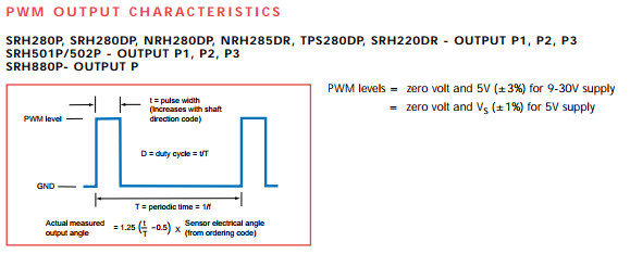

Postby greenamex2 on Mon Oct 23, 2017 2:46 am
A picture to help explain!

Postby David Ferguson on Mon Oct 23, 2017 5:12 am
Can you describe the pedal output in more detail.
My guess is that you don't really want to have Throttle Pedal Sensor Main Digital Decode Type as Pulse Width, but really want Frequency as then the B output is the duty cycle (0-100%), not the fixed pulse width maximum of 5 ms.

Postby greenamex2 on Tue Oct 24, 2017 7:50 am
Definitely PWM
