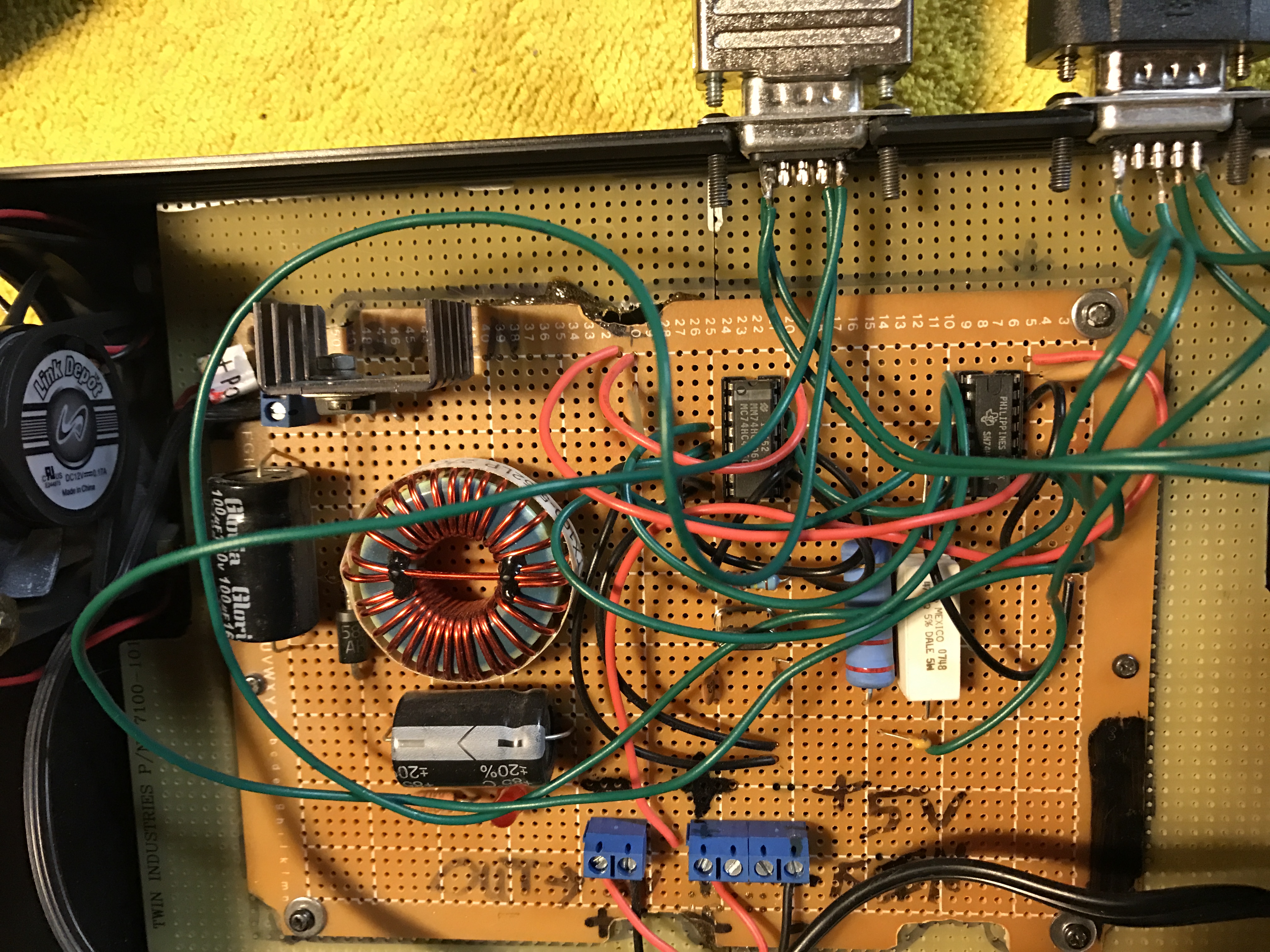

I made a clock generator/transit modem that works great.
Mine has an onboard +5V voltage regulator with a heat sink bolted to it and is wired to a +12V automotive cigarette lighter plug.
I even went overboard with the coil and crystal sizing, and it has no oscillations or issues whatsoever. I also added a cooling fan and grill for both ends. Runs cool as a cucumber!

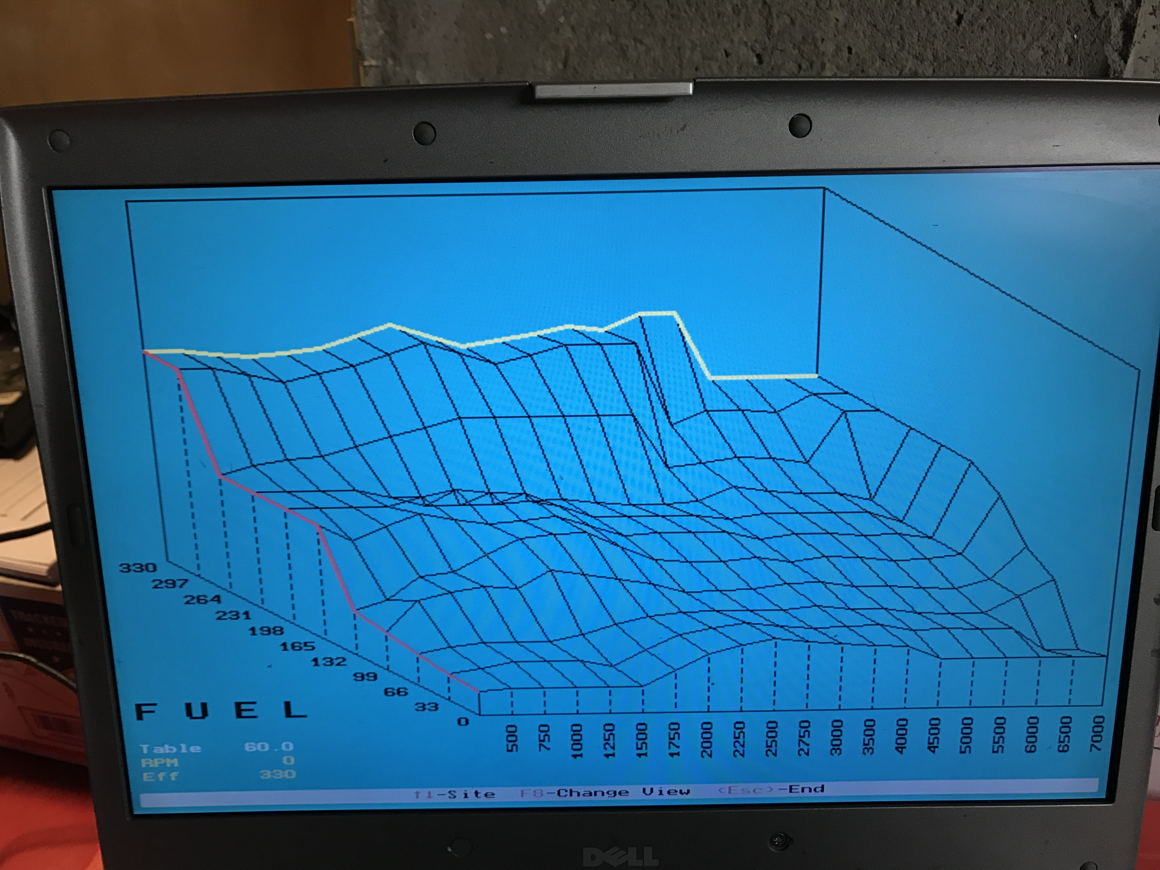

I am running Windows Xp on an old dell, with a Motec factory PCI cable 63003 and then a straight through DB9 cable.
Graphics are great as well as response to commands.
I think I bought two of everything I used on the transit modem, so it could be duplicated or repaired exactly.

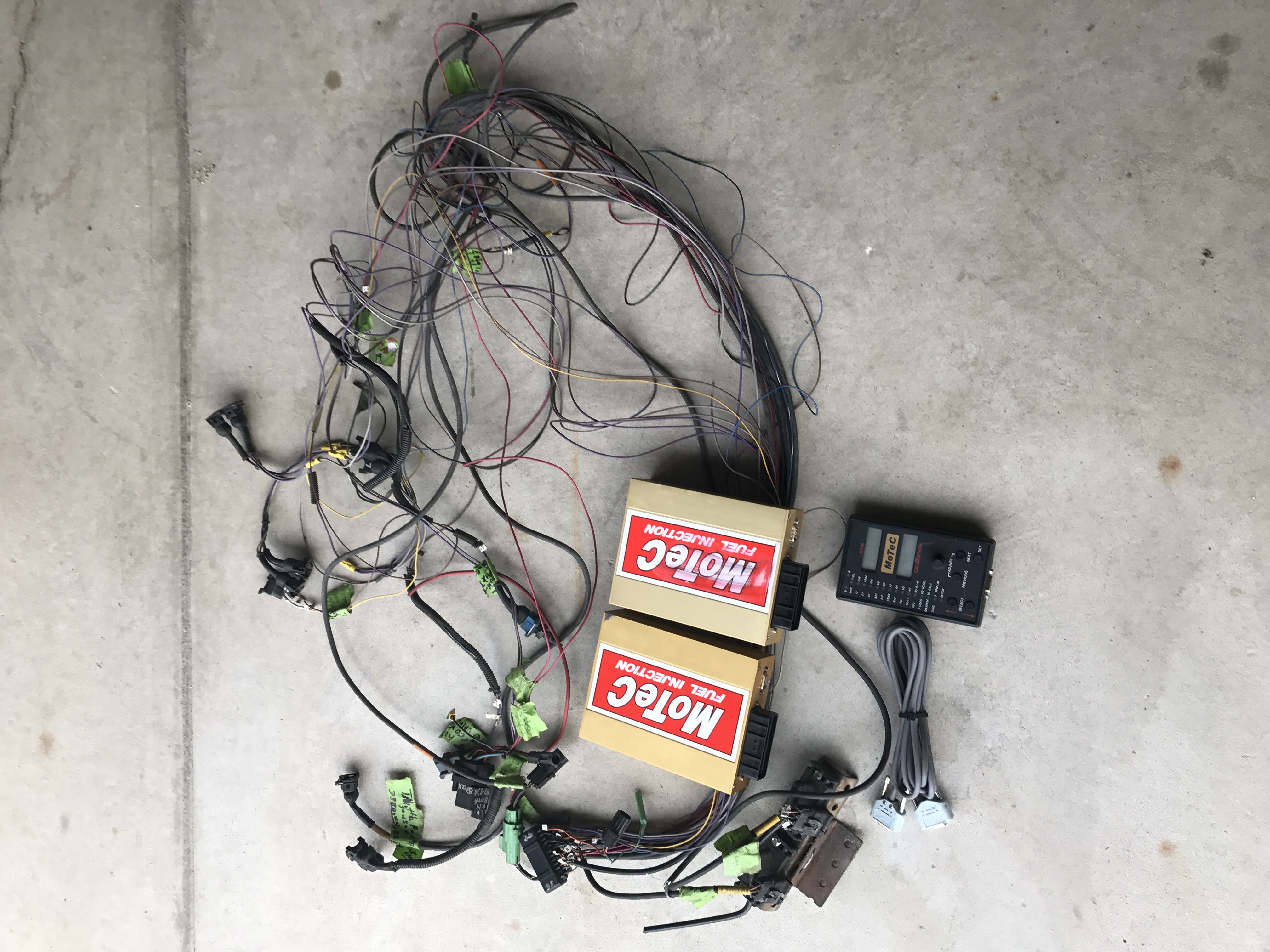

I am selling this clock gen/transit modem, two great working CEM-3D 2 group ECU's, one V8 engine harness, and a perfect working hand controller.
