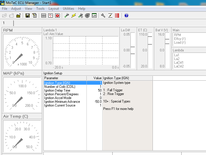

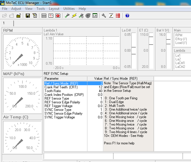

Postby Mohammed696 on Wed Aug 23, 2017 7:03 am
Please someone assist me and provide the configuration of REF SYNCE setup for Toyota Land cruiser 1FZ-FE engine.
And same for Nissan Patrol VTC TB48 engine (with Ignition setup).
See the attachment.

Why not just do a ref sync capture first and see if you are seeing anything in the graph? Then if the bars are overlapping change the rising or falling edge polarity of each opposite to one another.
