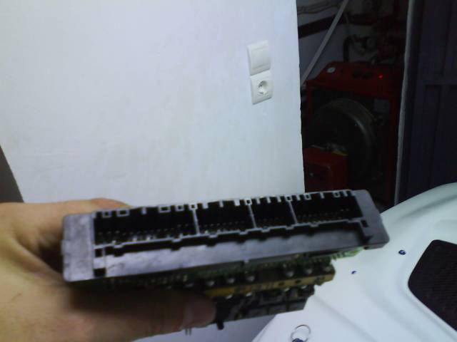

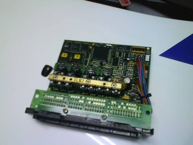

I´m being sold an ecu which is said to be a Motec M48 OEM for Evo. I´ve attached few pictures of it. Could anyone help me tell if this is legitimate? Does it have the same features of an gold box M48 besides not controlling 8 injectors? Thanks

It looks like an EVO M48 OEM (possibly EVO6). The M48 OEMs were literally an M48 without the case or connector and the heat sink was slightly smaller but apart from that there is no difference. All M48s use the same software.
You could use this ECU to run eight injectors (still an M48 remember) but in an EVO the four spare injector outputs were generally used for other functions.
