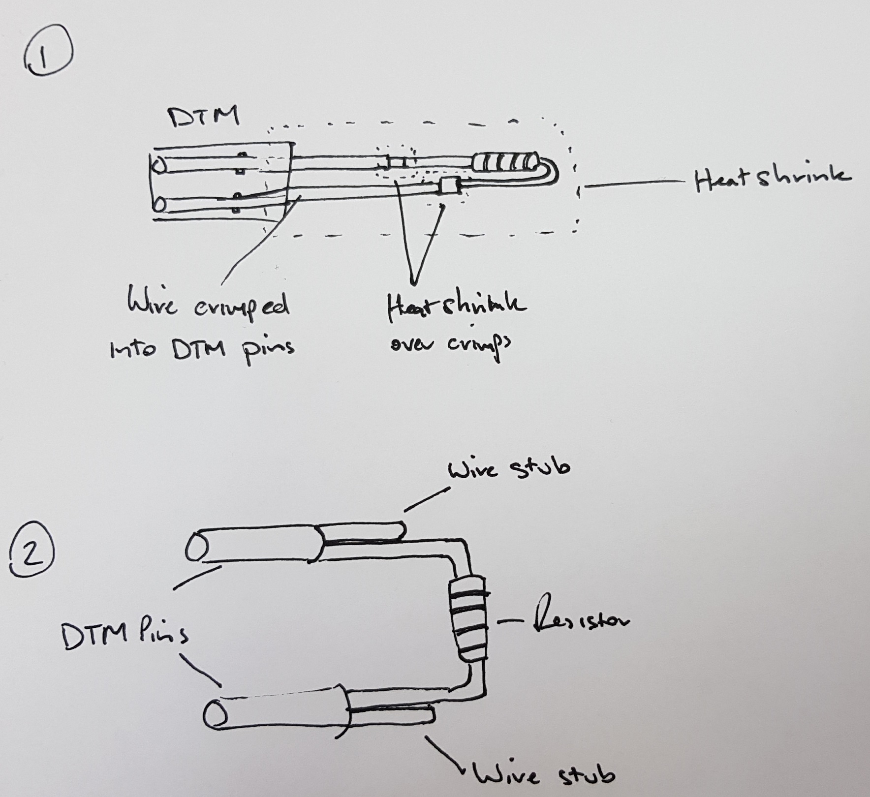

Just to triple check this, as I am not intimately familiar with resistors:
I have obtained a 270R 1/2W (no 1/4's available) and I am wondering if I can install this INTO a Deutsch 2 way connector instead of hard-wiring it?
If you can imagine, Signal wire splice into a V with the resistor wire heading into one side of the connector. Resistor sitting inside the connector, with the other resistor wire crimped inside the pin, and then the 5V and Signal coming out the other side of the connector.
Any issues in doing this? Probably need a few dabs of solder on the resistor wire crimp...
BJ 991
Posts: 20
Joined: Sat Jan 27, 2018 7:17 pm
Re: Simple SDL3 Fuel level sensor question
Postby adrian on Tue Feb 20, 2018 12:01 pm
That setup sounds fine, I can't see any issue with doing it that way.
A 1/2W resistor will work fine as well, it is just physically bigger than the 1/4W. I would however advise against using solder in the terminal. There are two ways I would wire the connector:
1. Crimp the DTM pins onto some wire and then crimp the resistor to the wires
2. Add wire to the DTM pin to get a better crimp.
Resistor Crimping.jpg (503.76 KiB) Viewed 28730 times
I would always do it using method 1, it takes a bit more effort but it is the most robust way (I have found) of wiring in a resistor.
Postby BJ 991 on Tue Feb 20, 2018 7:58 pm
Thanks Adrian! Particularly for the tips.
I'd originally envisaged something along these lines.
