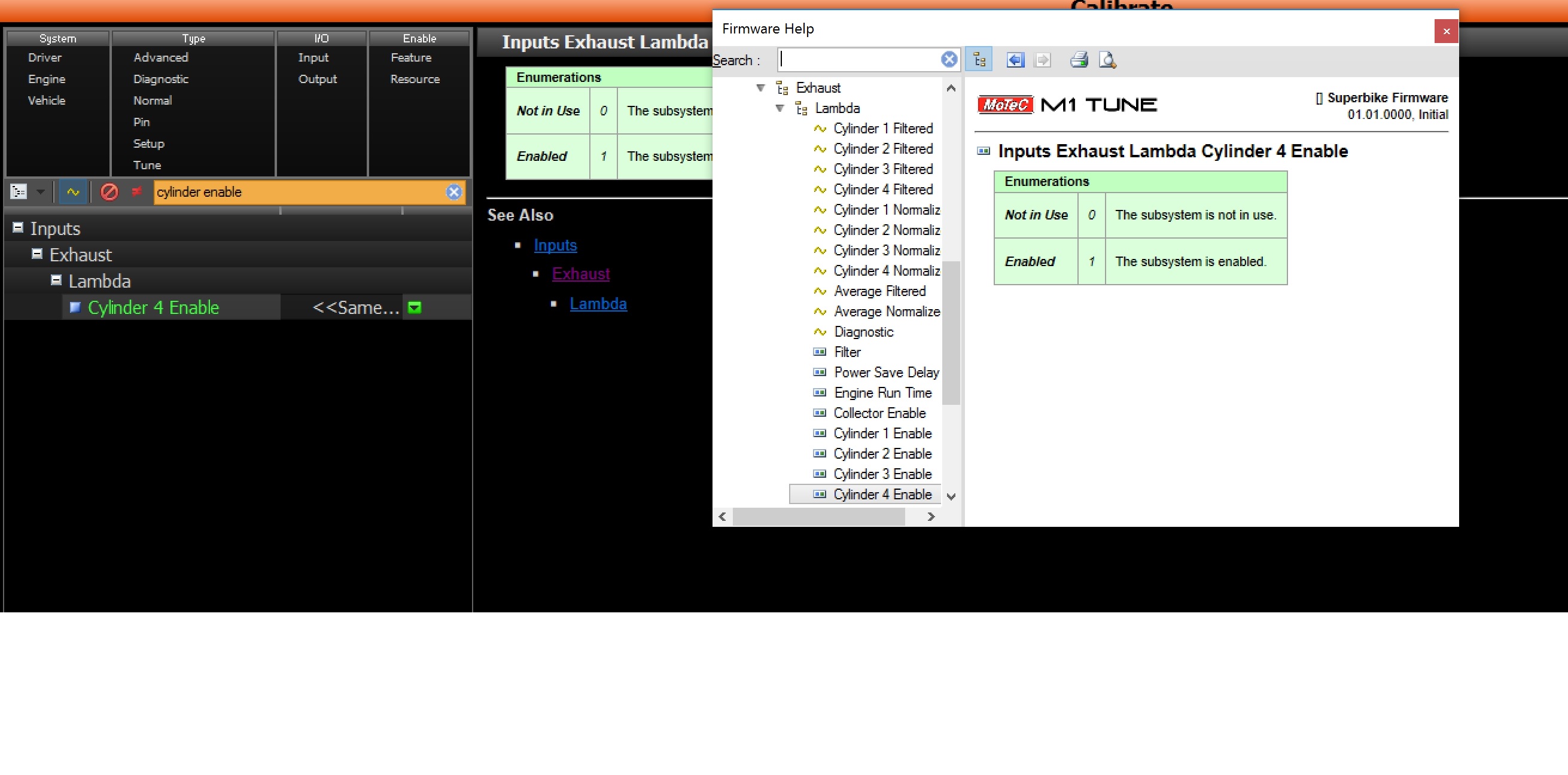

I created a new M1 Build that contained four cylinder enable parameters (see picture). In M1 tune, only one of those four can be accessed, although the firmware help shows that all four enable parameters exist. has anyone else encountered this issue?

Just a thought -- Can you show maybe a screen shot of build with each parameter object selected so we can see the properties? What does the associations show -- are these parameters used by enabled objects?
For example, LTC "Exhaust Lambda Cylinders" don't show up until the Exhaust Lambda Cylinder X CAN bus has selected (i.e. changed from "Not in Use").

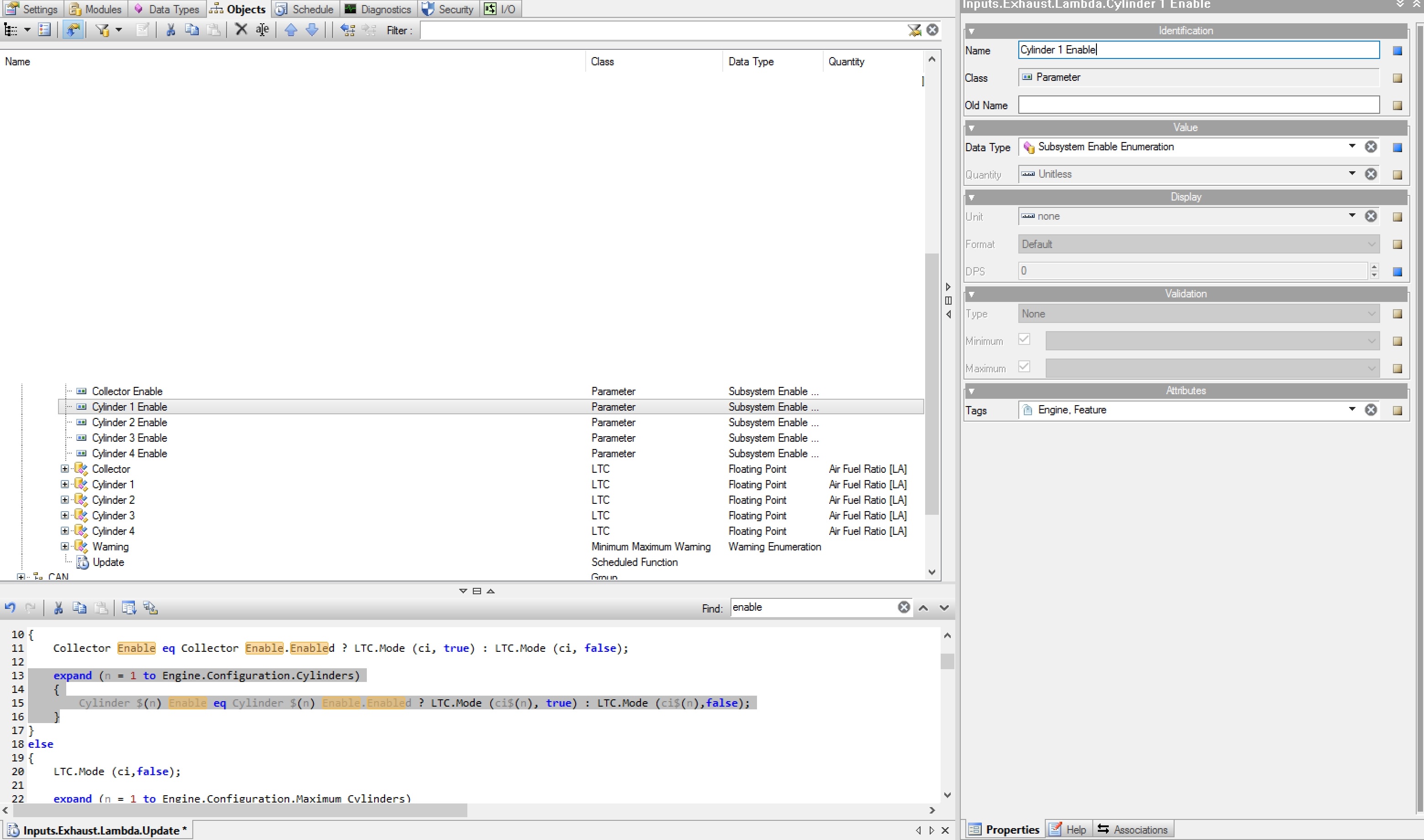

The parameter for each of the four Cylinder [1-4] Enable parameters is a Subsytem enable enumeration. I also tried a custom, project specific, enumeration (with not in use/enabled enumerators) instead, but no different. I attached a picture of the build showing the parameters for one of the cylinder enable parameters.
Parameters not visible in M1 tune 2.jpg (622.02 KiB) Viewed 20837 times

Since only the last enable in your list appeared to work, I wondered if there is a limit of a single "subsystem mode enable" per level in the hierarchy. Perhaps you need to place the parameters inside the collector and cylinder objects?
I noticed that in the GPA/GPR package this is done with the Channel $(n).Diagnostic neq Cylinder $(n).Diagnostic.Not In Use... So they look inside the Cylinder object to test for the enabled state -- perhaps you should put your parameter there..
